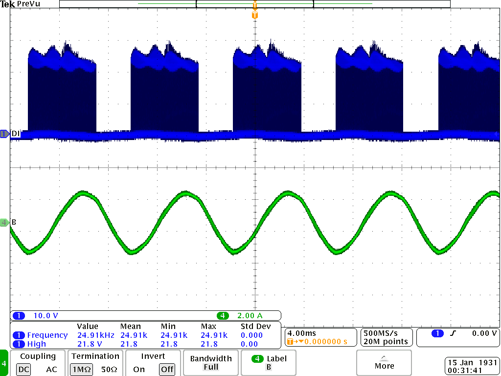

First of all, I will briefly explain my experiment:
Motor RPH_CT=0.4Ω,Kt=63.568mV/Hz,4000RPM,24VDC,polar logarithm=8。
According to the setting suggestion in Drv10987 Tuning Guide document, the open to closed loop threshold should be selected as one third to one fifth of the maximum motor speed, in this case, it is 106hz-177hz. Therefore, the setting value of open to closed loop threshold in this example is 128Hz. The experimental results are consistent with the description in the document. The waveforms of phase current and phase voltage are shown in the figure below.
In practical applications, customers may also want to try a lower threshold so that the motor can ramp faster from zero to full speed. This is because the motor accelerates faster in a closed loop. When we set the switching threshold to less than one fifth of the maximum speed, and we observe the waveform of the phase current. Now let's take specific examples:
We set the open to closed loop threshold to 12.8hz, 25.6hz, 38.4hz, 64Hz, 76.8hz and 128Hz.When the threshold value of threshold is reduced, the harmonic in phase current will be more serious. At the same time, the switching failure from open-loop to closed-loop may occur when the threshold value is low. This is mainly because the equipment triggers the current protection due to the sudden increase of current during the switching process. Here we do not want to argue about the harm of low threshold, but try to analyze why low threshold will lead to current waveform distortion in open-loop state, and also want to understand why it is easier for equipment to switch to closed-loop state unsuccessfully in this case.

    Question 2: Open to closed loop threshold frequency
    Choosing the Open to closed loop threshold frequency depends on the maximum motor speed (electrical frequency) and more importantly, the BEMF constant Kt. In open loop operation, device estimates the BEMF constant Kt. Motor should be able to generate sufficient BEMF for the device to accurately estimate Kt within the chosen open to closed loop threshold frequency. If the Kt of the motor is high (>100 mV/Hz), then the motor can generate sufficient BEMF voltage even at lower frequencies so we can choose a lower open to closed loop threshold frequency. However, if Kt is too low (<10 mV/Hz), then the open to closed loop threshold frequency should be high so that the motor will be able to generate sufficient BEMF voltage for the device to sense and estimate Kt. While transitioning from open to closed loop, if the estimated Kt is not within the defined Abnormal Kt lock detect threshold, the device will trigger Abnormal Kt fault. This is the fault that you are seeing at lower open to closed loop threshold frequencies. Reason for the distortion in current waveform at lower open to closed loop threshold frequencies is because of wrong Kt estimation.

  • Vishnu
    Totally agree with you. Another question is we found the current distortion with sine wave control during low rotation speed (Like diagram Dong have shown in previous threads marked as 12.8Hz).
    I wonder to know are such a phenomenon is normal or not? What's the root cause of such a phenomenon?

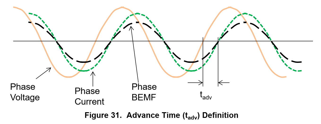

    The second thing I want to know is the meaning of commutation advance time control. Is it the similar as FOC control D-Q conversion>?
  • Hi Gabriel,
    Are the waveforms shown at different open to closed loop threshold frequency captured when the device was in open loop or in closed loop? I'm assuming this is in closed loop because it is normal to see current distortion when the open to closed loop frequency is set low because in open loop the device estimates BEMF constant Kt. For low Kt motors, the open to closed loop threshold frequency should be set high for the motor to generate sufficient BEMF voltage and the device to estimate Kt. When open to closed loop frequency is set low and if the current waveform in closed loop is distorted then the Kt estimated by the device in open loop may not be accurate. Device commutates based on the zero crossing information derived from the estimated Kt. Wrong Kt estimation leads to incorrect zero crossing and causes current distortion.
    Commutation advance time control is used to improve the efficiency of the device and motor. This parameter controls the phase difference between the phase current and the BEMF voltage. Maximum efficiency is achieved when the phase current is aligned with BEMF voltage. At this condition, the ratio between current drawn from the power supply (Icc) and the motor speed will be minimum and the angle between rotor flux and stator current will be 90 deg(optimum efficiency). This is very similar to setting Id=0 in FOC for non-salient permanent magnet motors.
