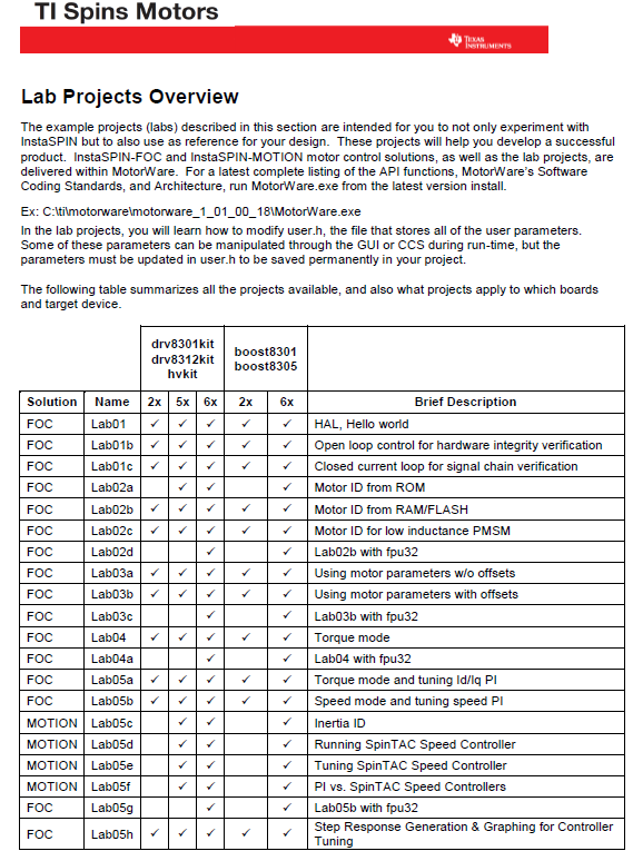

So I already have done the motorware labs and changed the user.h parameters sucessfully, but I dont know what are the motorware projects for? Are they just for changing the user.h parameters and testing the special functions? Or can they for programm the DRV8323RS? If not can you programm the DRV8323RS and how?

    Each of the motorware Labs are for progressively checking out the needed parts of the system for full FOC operation. There is a guide inside of Motorware you can check or you can post on the C2000 forum:
    Running lab 5B in CCS for example will allow you to input a speed command and have the DRV operate and control the motor.
    It is important to work through the labs in sequence as this prepares everything for successful operation.
