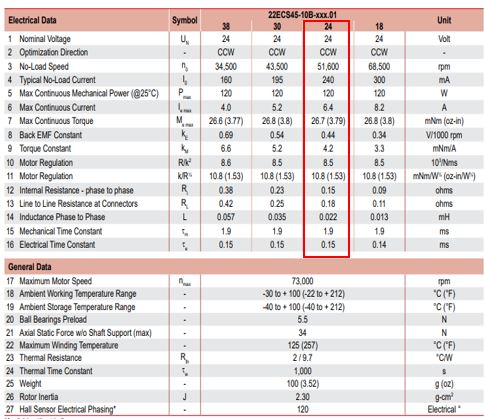

  • Hi Adam,
        Thank you for details,
    we want to run motor in open loop mode only.As requested by you below is spec of out motor. it is 2 pole.
    regards,
    Sayali
  • Sayali,
    With the DRV8306 you should be able to run the motor at the rated no load speed of 51.6kRPM.
    The assumption here is that the DRV8306 has enough voltage to drive the BEMF of the mentioned motor and it can read the hall sensors at less than 30kHz.
    -Adam
