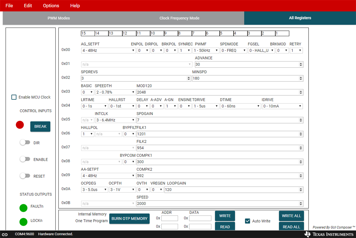

2 when i first test it, i changed some register value,but i forgot record the initial value,do you have the value numbers?The evm board can no longer close the loop at a lower speed. I tried to adjust a lot of register values, but I can’t find the original state.

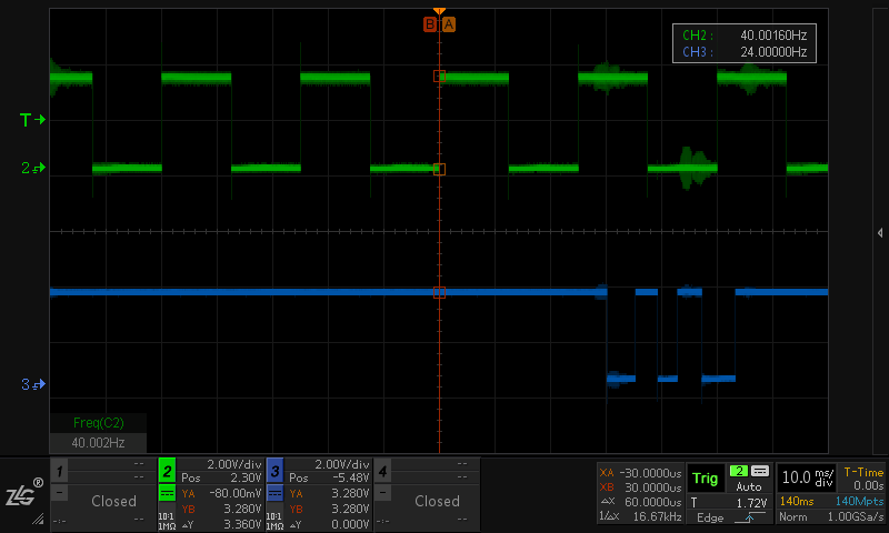

  • test video is as below,extern clock frequency is 40 hz.
    register setting is as below
    clkin and fg waveform is as below
    Thanks for posting on the MD forum!
    If you power off the EVM, remove the USB connection, restart the software, and reconnect everything again, the default settings will be loaded. Please try this first.
    -Adam

    i have tested the evm board with the motor in the evm case after fullly reset the board.i found that the motor spun roughly at clock frequency lower than 50Hz that generated by the msp430,even though i changed some register value,just as my video uploaded yesterday.And the motor couldnot turn to close-loop mode.i also found the maximum speed of the motor with the evm board was about 175Hz,ang the minimum speed was about 50Hz.

    The default values for the GUI and EVM should work correctly for the motor provided in the kit.
    Did you try the tuning steps as listed in the User's Guide?
    -Adam

    I tried the default value.these setting could make the motor spin at a higher speed than 50Hz.But when i tuned the speed down lower,the motor works not good,such as the motor spin step by step,and some times the power supply seems to be disturbed.After i changed the reg values as it says in the manual,he motor could spin smoothly at a speed of 40Hz,but I still cannot find the corrext value to make the motor spin at a lower speed.My desired speed is 200rpm.

  • There is a lower limit to the MSP430 PWM generation, also with low pole count it is very difficult to spin at low RPM.
    Can you try a different motor with higher pole count?
