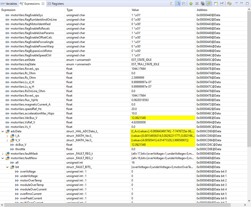

BOOSTXL-DRV8320RS: moduleOverCurrent Error
Part Number: BOOSTXL-DRV8320RS
We have recently swapped R10, R11, and R12 out from 0.007 to 0.3 which should now be producing an ADC full scale current of 1.000A.  However, when we run lab 5 and enable run an over current fault is triggered right away.  The software current max is set to 0.6A and we are not seeing the power supply ever providing any current.
We are running a 12V motor and to get better BEMF resolution we swapped out R1, R2, R3, and R28 with 16.9K to achieve a new ADC full scale voltage of 14.476.
Any ideas why we would be seeing the over current fault?

  • You might use a lower shunt resistor first, it seems like the peak phase current of the motor is greater than 0.5A.
    Change the overcurrent value by Increasing motorVars.dacValH and decreasing motorVars. dacValL as below formula.
    motorVars.dacValH = 2048 + (overcurrent value/ USER_ADC_FULL_SCALE_CURRENT_A)*4096
    motorVars. dacValL = 2048 - (overcurrent value/ USER_ADC_FULL_SCALE_CURRENT_A)*4096
  • We are getting this moduleOverCurrent error even when in lab 2 and not driving the motor.  Could there be an issue with the current sense?
    Also, our current offsets seems correct but should the voltage offsets be around 0.5 of bus voltage?
    #define IA_OFFSET_A (-0.51097733) // ~=0.5*USER_ADC_FULL_SCALE_CURRENT_A
    #define IB_OFFSET_A (-0.50316352) // ~=0.5*USER_ADC_FULL_SCALE_CURRENT_A
    #define IC_OFFSET_A (-0.51292282) // ~=0.5*USER_ADC_FULL_SCALE_CURRENT_A
    //! \brief ADC voltage offsets for A, B, and C phases
    #define VA_OFFSET_V (6.08585739) // ~=1.0
    #define VB_OFFSET_V (6.12417555) // ~=1.0
    #define VC_OFFSET_V (6.08232307) // ~=1.0
  • Yes, over current must be from the current sensing.  The USER_ADC_FULL_SCALE_CURRENT_A could be too small for your motor.
    The voltage offset should be a value close to 0.5 on all of the board. You might enable offset calibration by setting motorVars.flagEnableOffsetCalc to 1.
