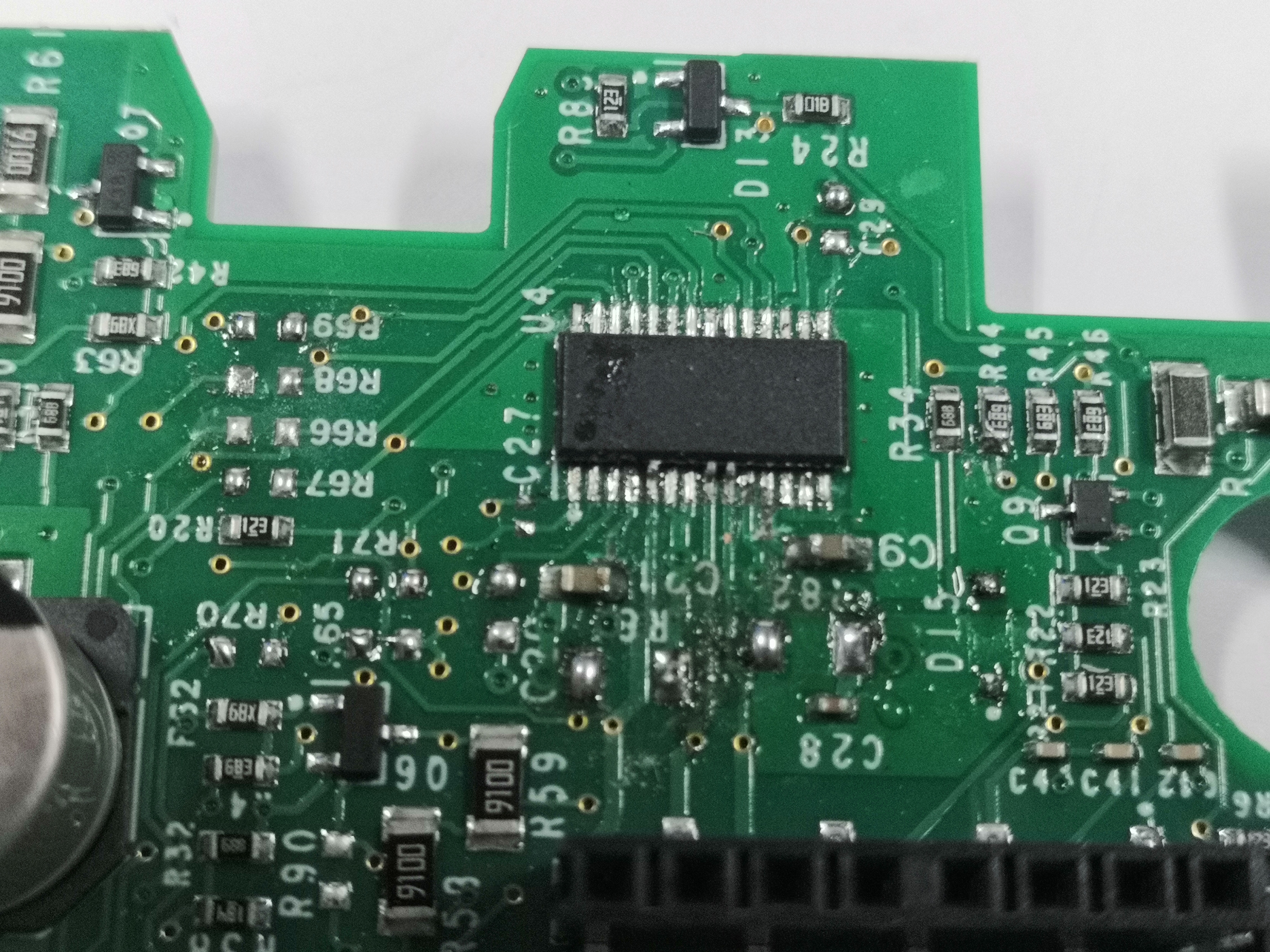

Recently, I took over an actuator project and found a strange phenomenon. Drv8313 is connected to BLDC and does not supply power to drv8313. Dragging BLDC finds that sometimes there is braking phenomenon, sometimes there is no braking phenomenon (power supply circuit and PGND circuit have been disconnected). Why is this?. In order to eliminate the influence of my peripheral circuit, I broke all the pins of drv8313 (except the three pins connected to the motor), and found that there were still braking phenomena sometimes and sometimes none. Three of them were tested, and there was no rule~

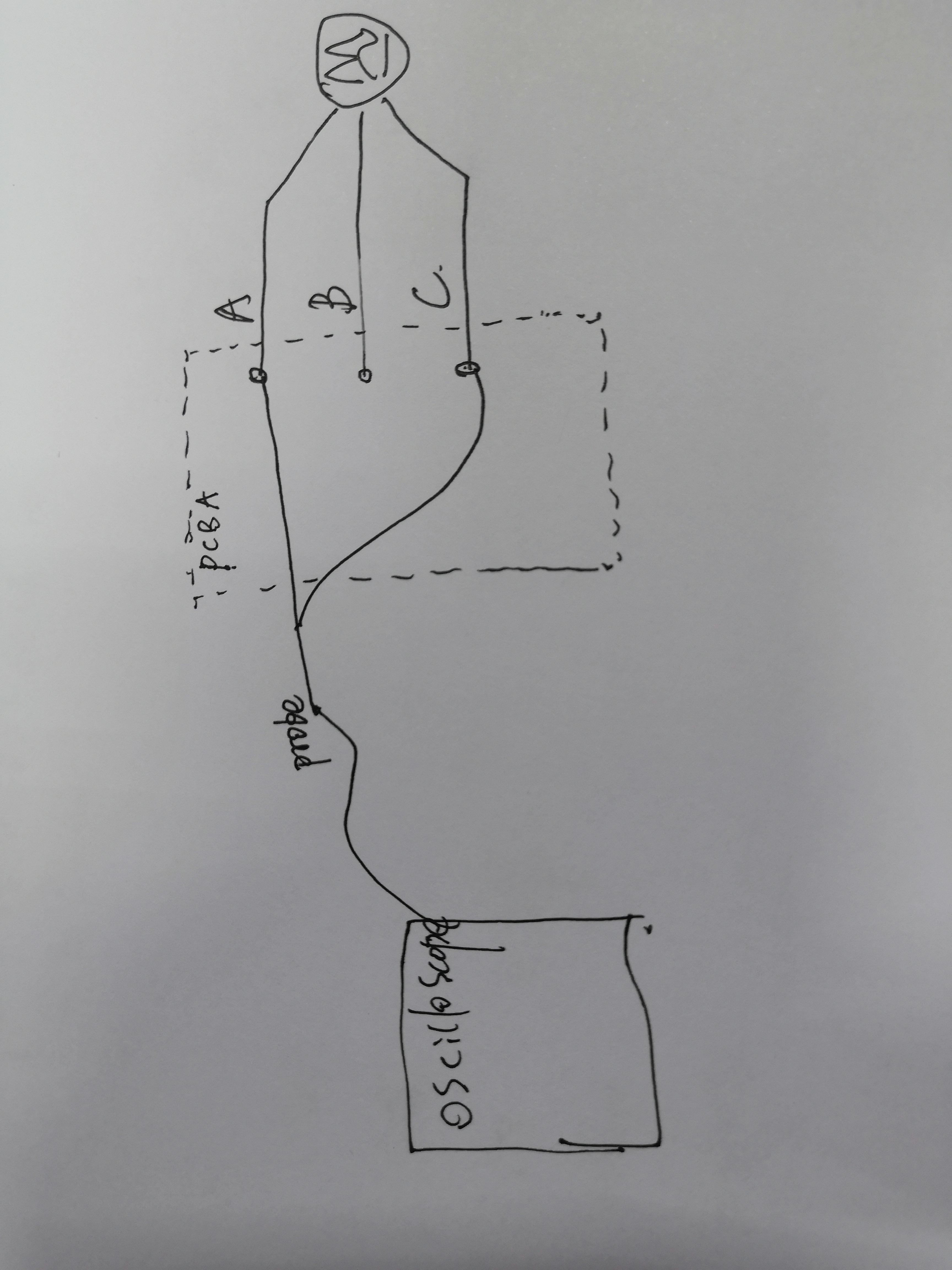

  • Bangjing,
    If I understand your question correctly, all pins of the DRV8313 are disconnected from the PCB and only OUT1/OUT2/OUT3 are connected to the motor?
    Can you show a picture?
    -Adam
  • Bangjing,
    Can you show us a scope image of the motor terminals during these two conditions?
    -Adam

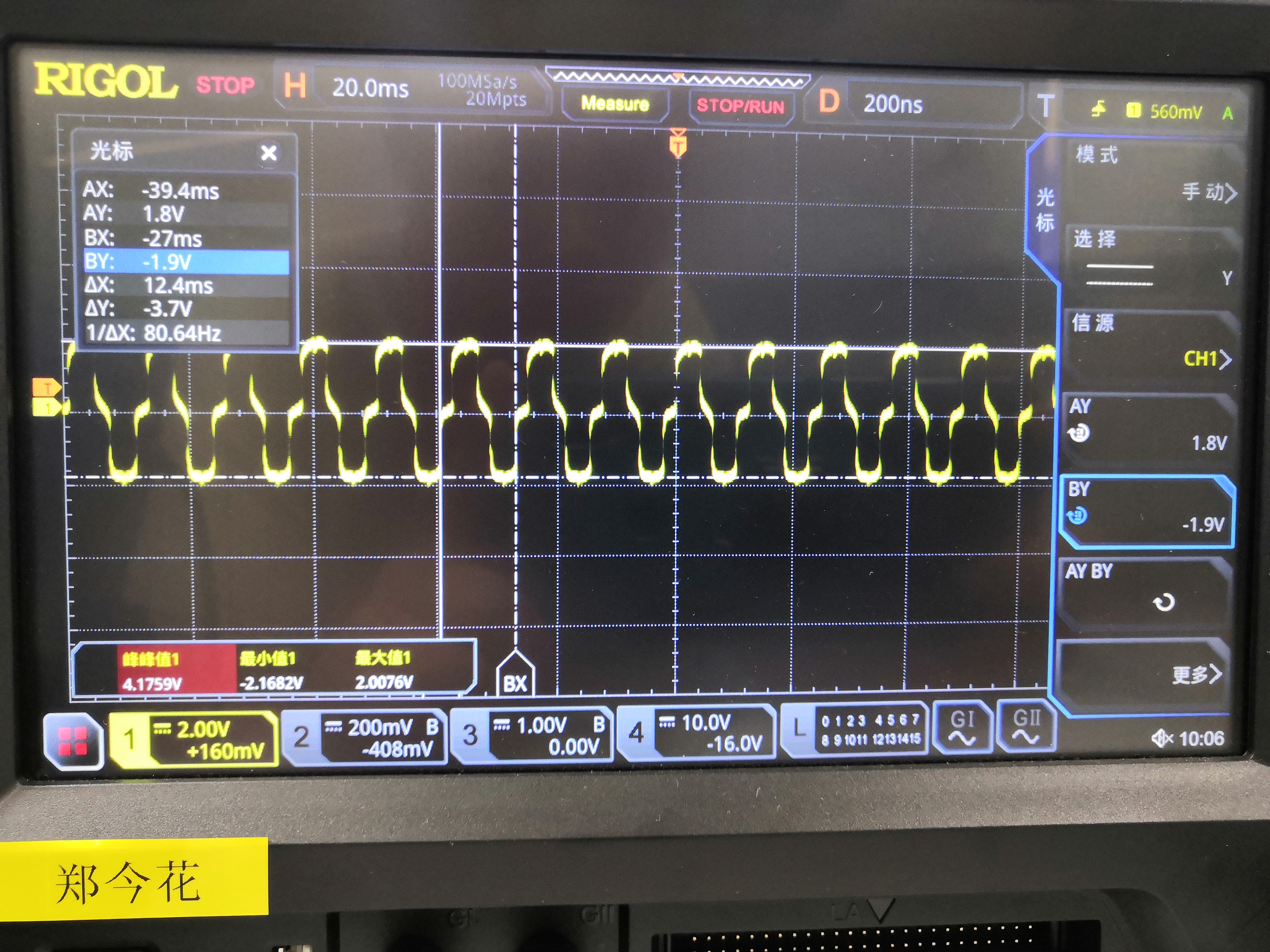

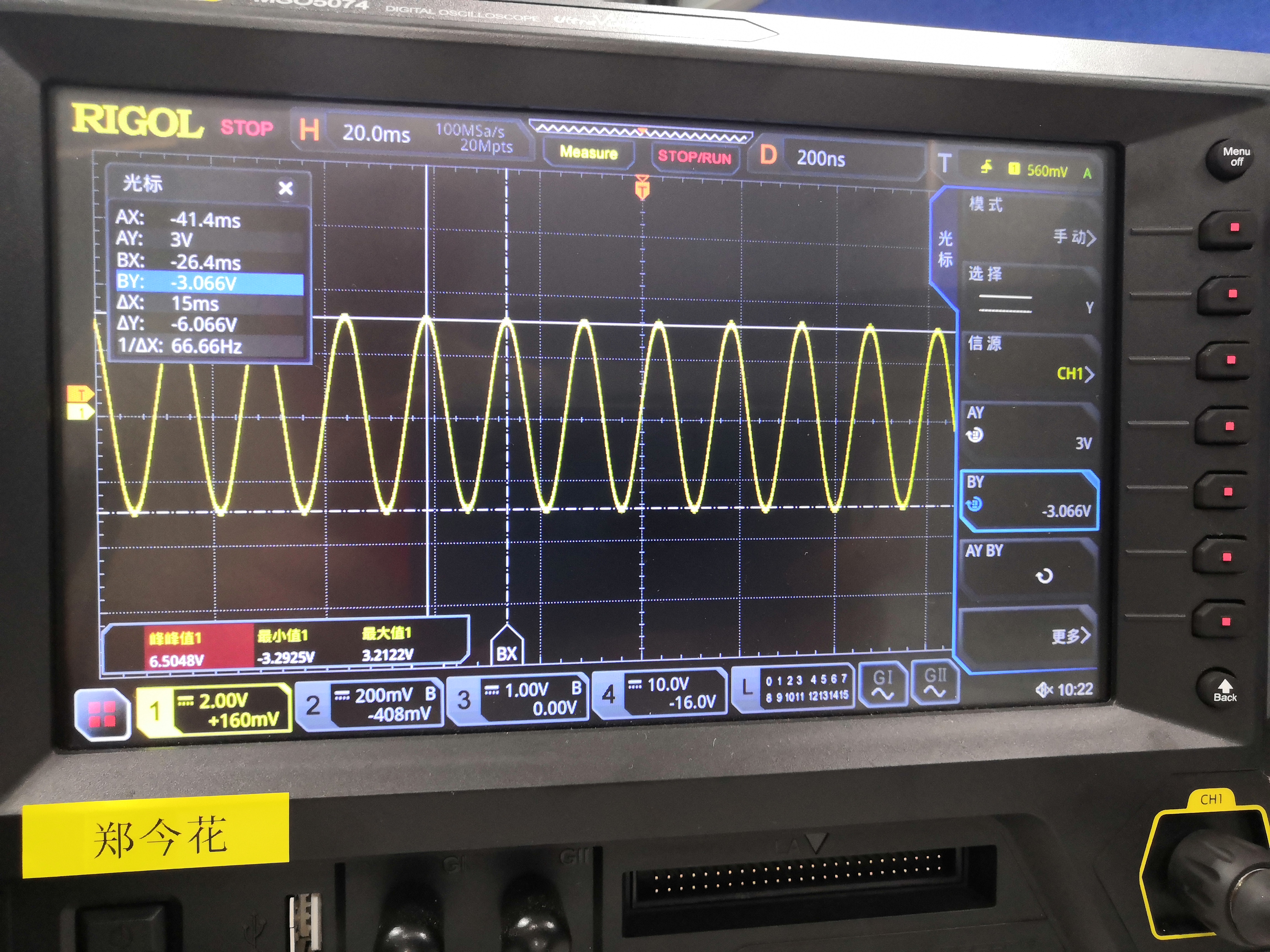

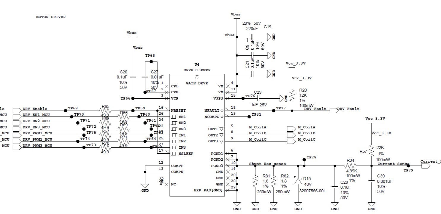

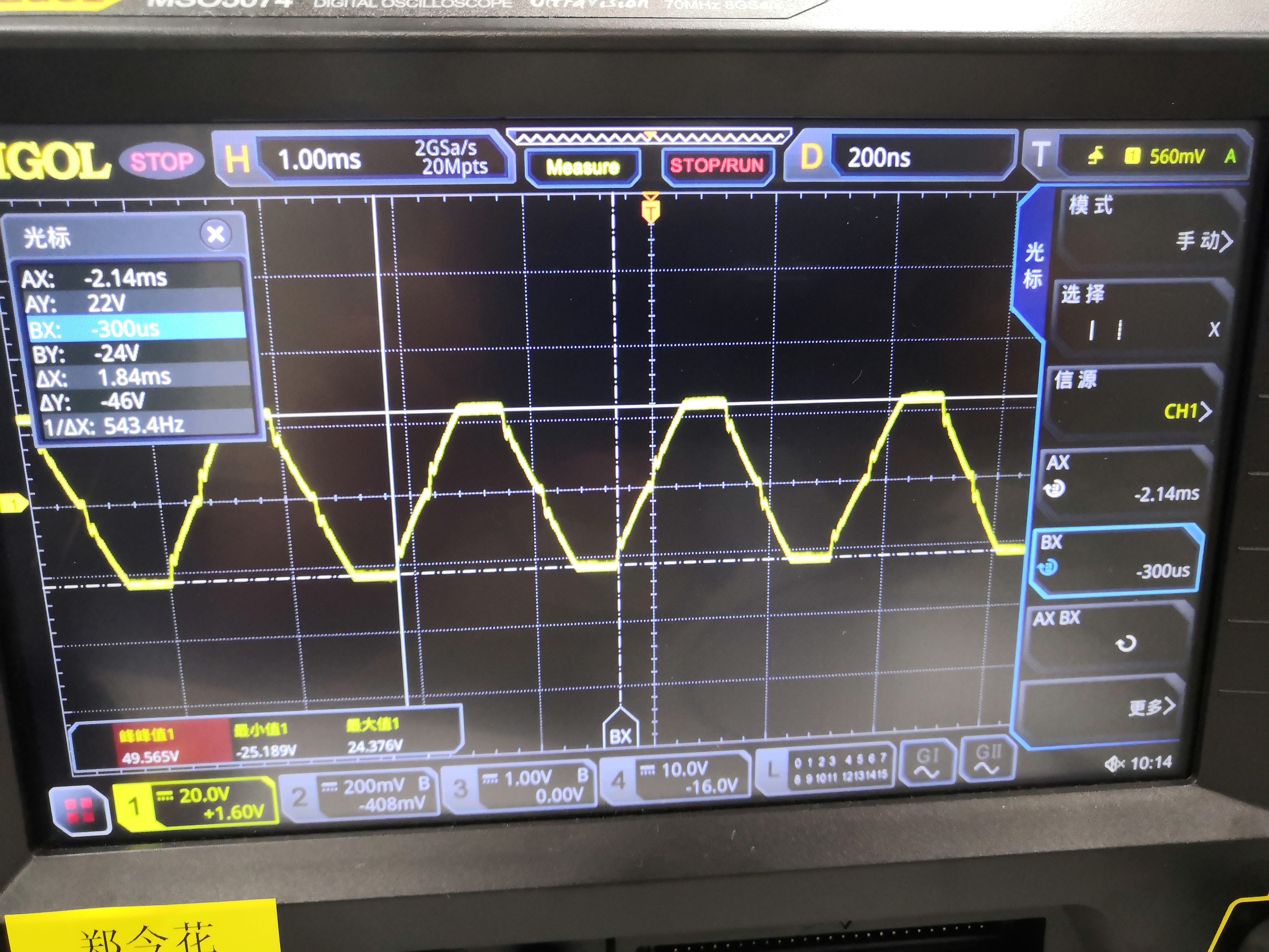

  • first is connection diagram
    second is brake phenomenon waveform
    third is no brake phenomenon waveform
    fourth is no brake phenomenon but limit speed waveform
