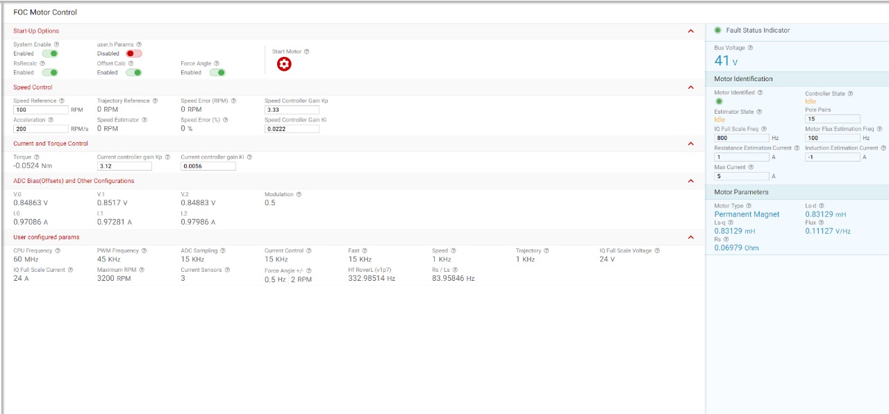

We have a DRV8353RH eval board and a 42V PMSM Motor. We are connecting both and using the DRV8353Rx 1.0.1 GUI utility to identify the motor parameters.
This is what happens:
- We start the motor identification process in FOC Motor Control mode.
- Motor starts spinning and the tool identifies the motor parameters. There is a bit of noise in the motor during EST_State_Ls state
- The Rs value is reasonably consistent but the Ls value varies drastically for each identification
- The TORQUE value is very low and in negative
- The Max RPM detected is high. Generally electric scooter motors rate around 600RPM. But tool says it is 3200RPM
- Tool says motor is identified successfully. Now we try to start the motor and with the speed reference at 100RPM
- There is a lot of noise from the motor and it jerks a bit but doesn't run
- We stop the motor at this point lest it gets damaged.
Can you help understand what we are missing here? PFB the utility screenshot for reference with the motor parameters identified
- Both the motor and the battery were removed from a Electric scooter. We don't have it's spec.
- DC Voltage 42V [Rating on the battery confirmed by the BUS voltage detected by the DRV8353Rx utility]
- Max Motor current 5A [Based on battery rating]
- Number of poles: 15. [We ran the motor on the scooter and probed a HALL sensor line on an oscilloscope and counted the number of pulses for 1 RPM]
Settings on the Utility:
- We are using the automatic Motor identification mode in the utility by disabling user.h Params and enabling RsRecalc, Offset Calc and Force Angle.
- Pole pairs set to 15
- Motor Flux Estimation Freq set to 100Hz
- Estimation currents set at: 1A & -1A
Any help is much appreciated. Thanks in Advance.
