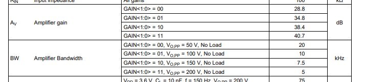

Does the specification of gain of the DRV8662 datasheet GBW, which means we can support frequency range 20kHz/28.8dB = 20kHz/27.54V/V = 726.15Hz with 50V VPP configurations?

Hi, Wayne,
The BW spec in the datasheet means that the DRV8662 is capable to reach up to 50V from 0 to 20KHz. If higher output is required, the bandwidth will be reduced.
Let me know if you have additional questions or comments.

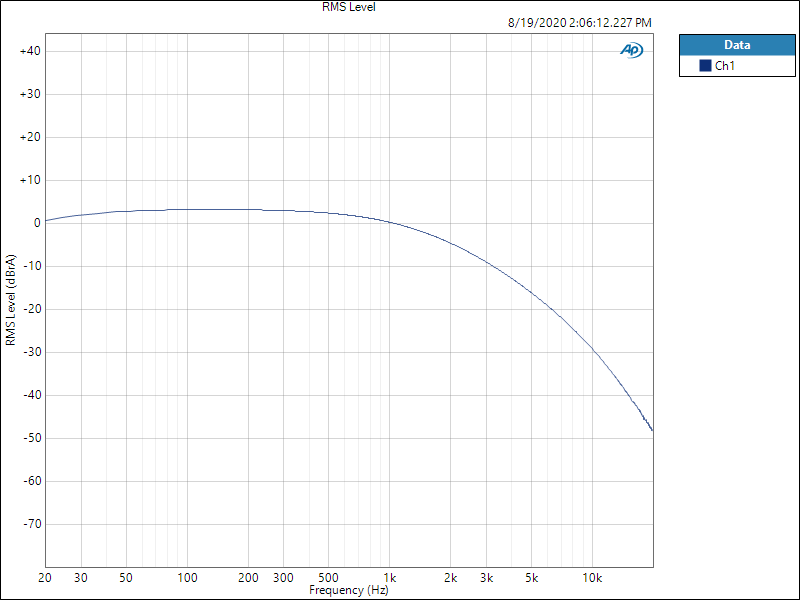

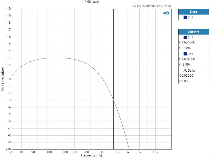

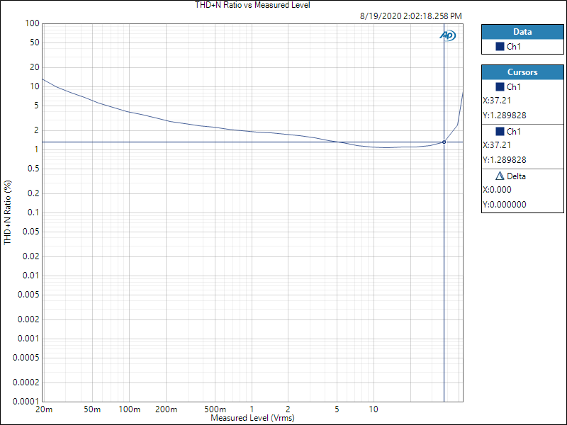

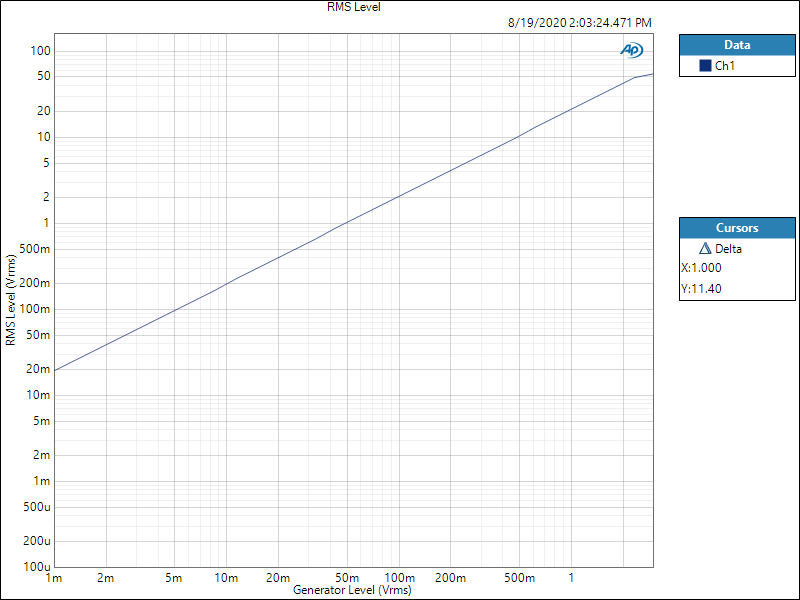

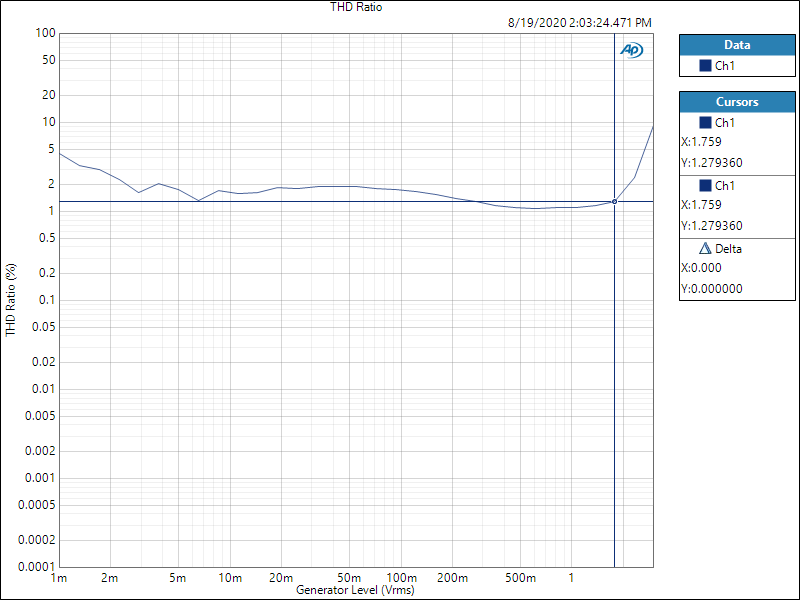

Hello Luis,
The specification could be GBW according to my frequency response plots on the DRV8662 EVM with 110nF piezo actuator load.
Would you please provide recommendations of them?
VBAT = 5V. GAIN=0GAIN1=High
VIN to VOUT
Full Scale Vout = 37.21Vrms @ 1kHz
Full Scale Input Vin = 1.28Vrms @ 1kHz
Frequency Response:
Zoom-IN (f-3dB at 1.6kHz)
Thank you and Best regards,
