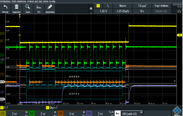

We are currently facing an issue, when trying to write on the driver registers via SPI.
Below the procedure that we followed.  Please note that the 3 « LOCK » bits located in Gate Drive HS Register are configured so that registers can be modified (011b).
Channel C1 : Chip Select
Channel C2 : Clock (300kHz)
Channel C3 : MOSI
Channel C4 : MISO
  1. Reading Gate Drive HS Register (adress 0x03) : we send 0x9800 on the bus
  1. Changing IDRIVEN_HS value from 2000mA (1111b, default value) to 1640mA (1110b) : we send 0x1bfe on the bus
  1. Reading modified Gate Drive HS Register : we send again 0x9800 on the bus à NO CHANGE (driver should have sent back 0x03fe)
Are we doing something wrong ? Any other lock bits to be configured ?

  • Hello Mr Barrera,
    I just did the manipulation, and no change at all. I can read registers but not write any of them...
    However, I did some other tests by my side and observed that the clock polarity could be in cause of this strange driver behavior.
    By changing this parameter (clock pin level low when idle) the driver seems to take writing command into account...but now the hexadecimal value sent by the master doesn't correspond to the value written on the SPI bus (everything is shifted by 1 bit) :
    1) clock polarity high when idle, as initally (reading driver registers ok but not writting).
    The master send 0x9800 to read the 0x03 driver register. Value on the bus correspond to the value sent by master.
    2) clock polarity low when idle (reading AND writting ok).
    The master send 0x9800 again. Value on the bus doesn't correspond to the value sent by master (one bit shift, seems like the first bit is missed).
    So clock pin level low when idle seem to be the right clock polarity configuration for the driver...Can you please confirm that ?

  • Hi Maxime,
    Could you resend the post with the screenshots again? The screenshots didn't go through on your previous reply. Please use the "Insert File" command to upload from your computer.
    Which MCU are you using for your SPI commands and initialization? Could you share your SPI initialization code?
    Typically you'll want clock polarity to be low so that SCLK is active high (transmit data on falling edge and receive data on rising edge).
  • Hello Mr Barrera,
    please find the previous screenshots below :
    - with clock polarity high when idle :
    - with clock polarity low when idle :
    Concerning the MCU, I use an STM32G4 with the following SPI configuration :
    - Clock phase : The first clock transition is the first data capture edge
    - Clock polarity : CK to 0 when idle
