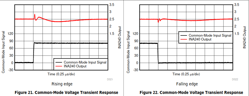

Also, I'm thinking about using INA240 in-line current sensors instead of low-side with PGAs: Do i still need to worry about minimum minWidth_usec for INA240 output settling (~1.25us) or PWM CMR spike and loose supply range? Or rather then i would have to set the trigger accordingly to the settling time, but without modulation limit  - up to 0% low-side on time?
And phase voltages don't need to be measured in specific FET state due to its RC filtering (apart from being synchronized with current), right?

    as said earlier, problem exists even with USER_MAX_VS_MAG_PU = 0.5, just when phase votlages reaches Vlimit (about ~0.44). I think the current reconstructions adds too much discontinuity, because of the noisy signals i have. I've managed to run it with USER_MAX_VS_MAG_PU = 0.5, with lower PID gains and little "resonance" at transition from ALL_PHASE to TWO_PHASE_MEASURABLE, so probably i'd have to implement variable gains and work on better signal quality. Then maybe 0.57 would work nicely and i could push it a little more with FW, to reach desired speeds.
    In my application, i'm trying to replace 6-step BLDC solution so i really need to utilize most of the available supply range to not loose performance. So that's why I would probably go with inline sensing, just to avoid those difficulties above...
    Yanming Luo said:
    Yes, current reconstruction is not necessary if using an inline current sensor.
    And how should i deal with the transients from PWM switching? High-to-low reponse looks much better, but still, this would cause about +/- 1.5A ripple at worst spot at the edge in my application.
  • That depends on the motor parameters and the current sampling circuit. Using a higher PWM and control frequency and tuning the controller (current and speed) could improve the performance also.
