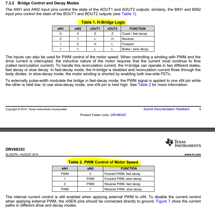

    b) Can the driver be driven with a PWM at XIN1 and the inverted PWM at XIN2? What needs to be considered regarding this? How do the different decay modes of the driver come into play regarding this, and what is their effect on the output current? What is the maximum delay that the inverted PWM should have with respect to the PWM?
    A: XIN1 and XIN2 inputs should follow the control tables shown in the datasheet. If you have inverted PWMs in both XIN1 and xIN2 (assuming there are no overlapping section between the two PWM signals), then according to the control table, the outputs will just be changing direction (forward and reverse) without entering decay mode. Decay mode happens either when both xIN1 and XIN2 signals are LOW or HIGH.
    c) What needs to be considerered regarding different duty cycles ( between 10% and 50%)? Does the driver go into different modes for different duty cycles?
    A: The driver sets the outputs to different decay modes depending on the overlapping sections of both PWM signals. If both signals overlap when both signals are low, then it goes to brake/slow decay mode as described in Table 1. In the case that both PWM signals overlapp when both are HIGH, then the outputs go into coast/fast decay mode. In the case that you have inverted PWMs with both HIGH and LOW overlapping regions. Then the outputs will be alternating between coast/fast decay mode and brake/slow decay mode.
