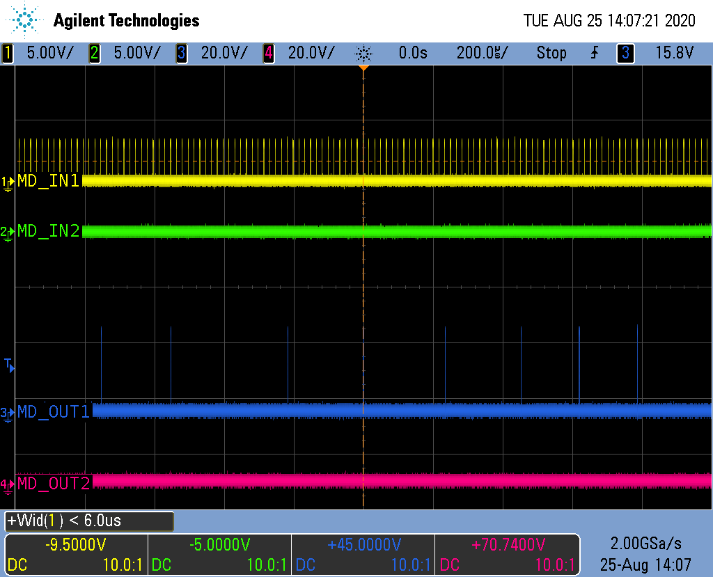

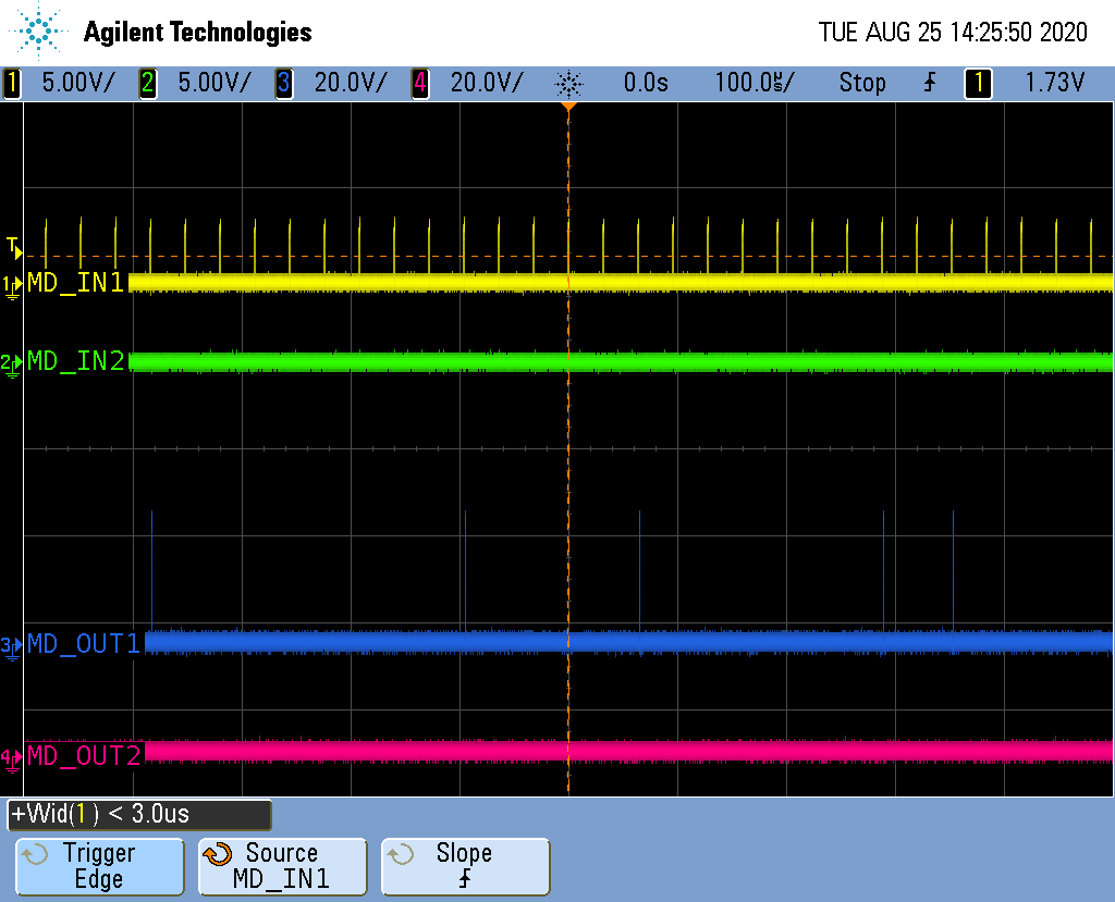

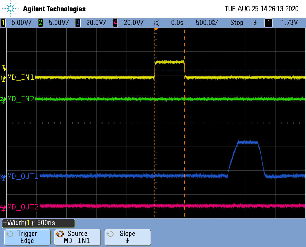

  • Hello Pablo,
    please find the figures below. Both present the same PWM condition, but different zoom. You can see that the input pulse is 500ns long but on output to motor there are pulses sporadically only.
    Under 500ns there are no output pulses at all.

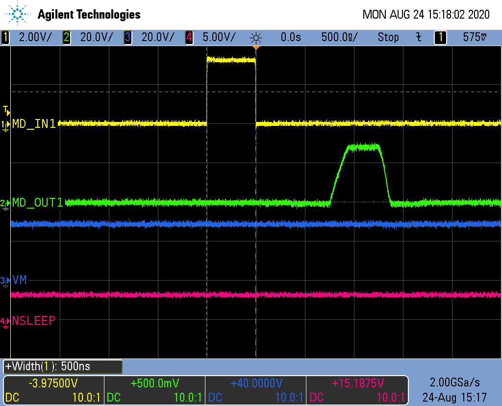

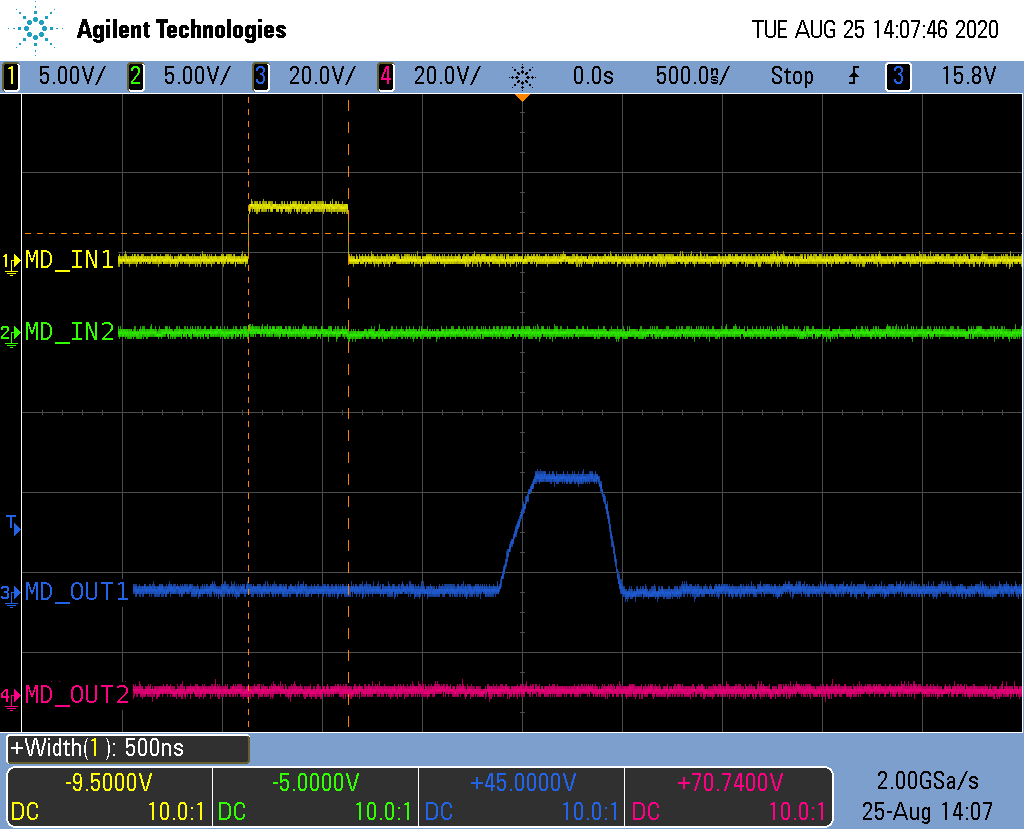

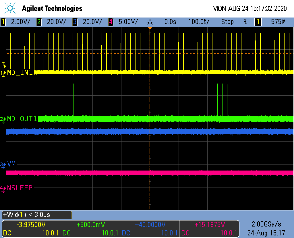

  • Hello Pablo,
    I'm PWMing only  IN1, IN2 is LOW, see scope_30 and scope_31 for detail.
    I also tried this test on DRV8842EVM with similar results - scope_32 and 33.
    Jaroslav

  • Hi Jaroslav,
    What I think is happening here is that the TON time (500ns) is too short and does not allow for the output to turn ON all the time. Can you try increasing the ON time to lets say 1000ns while keeping the same PWM frequency. If the sporadic pulses on OUT1 are still present with the higher ON time, then we'll have to take a closer look at either your set-up or the driver to understand the root cause.

  • Hi Jaroslav,
    Like I mentioned in one of my earlier replies, It is recommended that the minimum TON or TOFF width is greater than T_rise + T_fall. In the datasheet, the maximum rise time and fall time are 200ns respectively. Meaning to ensure there is enough time to properly switch the output state, you'll want a minimum of 400ns TON time. However, there might be cases where loading conditions can cause the rise time to be  higher than specified. In your case you have a 500ns width pulse and might be experience a corner case where the TON time is enough to switch the output but only in some instances.
