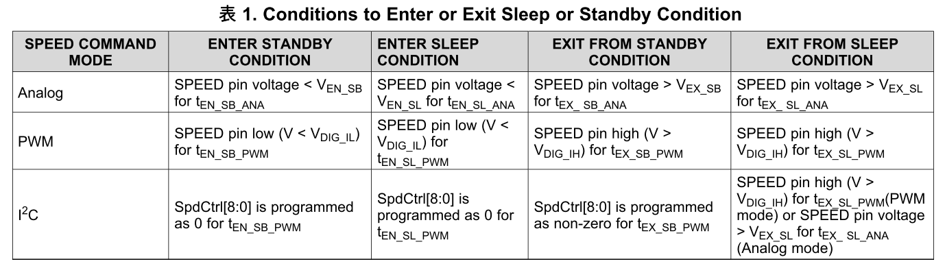

Hi all
Would you mind if we ask DRV10983?
How long does it take time from start up to Openloop operation?
We would like to know following ①;
①From start up to begining of Align operation : we could not find it on the datasheet.
②From Align operation to begining of Open loop operation : it depends on Align time setting
Especially, after Speed pin is added voltage, how long does it take time to start Align operation?
<Customer's setting>
Stand alone with EEPROM setting
Speed control is used for analog voltage.(Speed pin)
