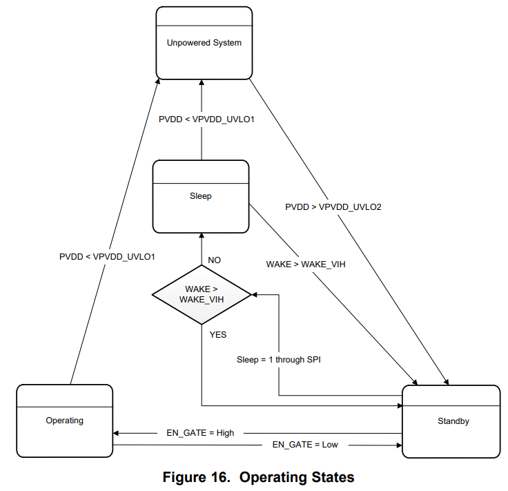

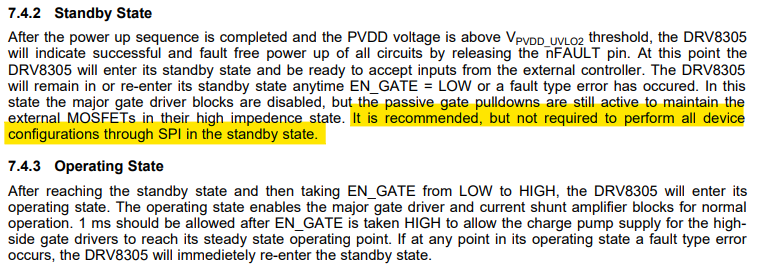

Hi Support team
The data sheet in 7.4 Device Functional Mode includes the following.
>IDRIVE Gate Current Output (IDRIVEN_HS, IDRIVEP_HS, IDRIVEN_LS, IDRIVEP_LS):
>All four IDRIVEXsettings may be adjusted during normal operation without issue.
When is normal operation?
Do I need to set EN_GATE to High for normal operations?
Is there a difference between normal operation and the Operating mode shown in Figure 16?
Can the control register be changed in standby mode (EN_GATE = Low)?
