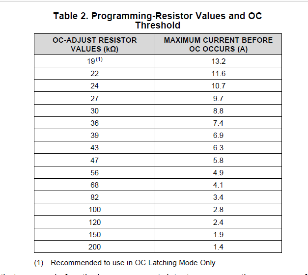

I am using DRV8312 to drive 3 phase BLDC motor. BLDC motor rating is 1 A . I want to use DRV8312 Cycle by Cycle current limiting function  so limiting the current 280 mA or lower value.
Table 2 does not show the resistör value for current lower than 1.4 A. According to table 2 of the drv8312 datasheet there is a inverse proportion between current and oc-adj resistor value . So ı put 1 M Resistör to limit current 280 mA (200*1.4/1000).
However drv8312 limiting the curretn 20 mA or lower. Even ı put 681K Resistör drv 8312 limiting current 20 mA and lower so motor shaking but does not run. If I put 510K or lower value resistör DRV8312 run without problem at 100mA  but this time I couldnt limit the current.
Why I couldt limit the current according to table? Is there any current threshold or something ? May be DRV8312 does not run with  higher oc_adj resistor value?

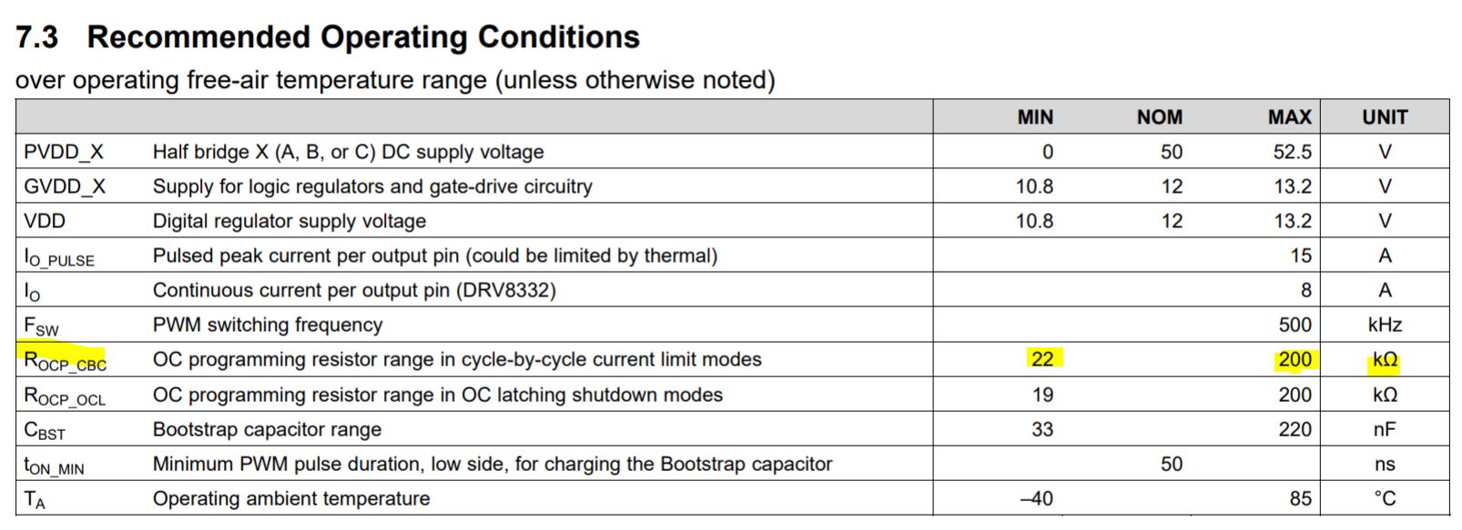

  • Hello Denizdeniz,
    Unfortunately, any value resistor outside of the 22 kOhm - 200 kOhm table is not recommended (see below) and could cause unexpected behavior, like you've seen on the bench. While I am surprised that 500 kOhm worked for you, the more important distinction is that the DRV8312 was not designed for use with a motor that will consume such a small current.
