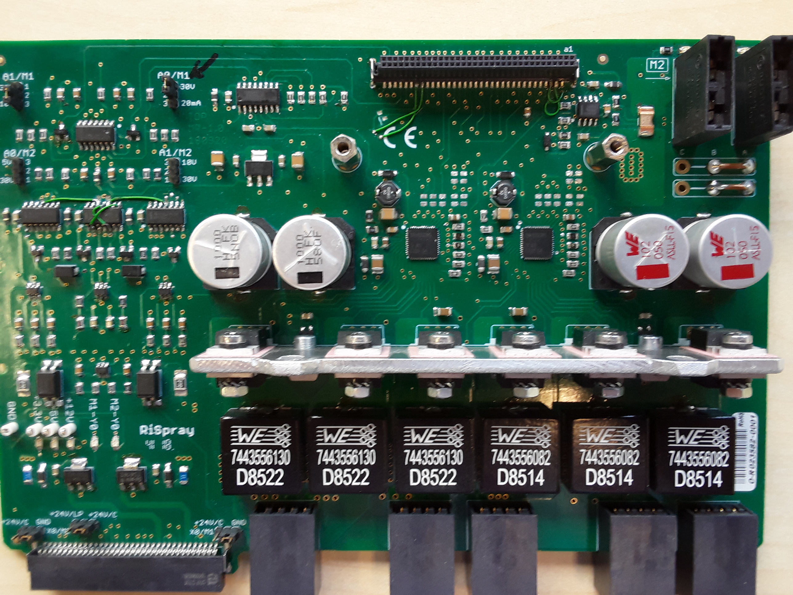

Hi Team,
The customer would like to confirm if it is possible to set hall inputs so that the motor locks instead of the motor running when using 1x PWM mode ( SPI only )
To prevent the coils from getting too hot, the current is limited to a low value.
So that they don't need an extra magnetic brake to block the motor in some circumstances.
Please let me know your inputs and if you have other questions with the customer.
Jonathan

  • Hi Cole,
    I got an update from the customer below:
    The customer wants to be able to break the motor when the motor is not running, thats all.
    For braking, while the engine is running we use a 4-quadrant control.
    It is for a cart to prevent if it is stationary does not roll away, that is for short times.
    Let me know your inputs.
    Jonathan
  • Hey Jonathan,
    Thank for the follow up.
    Unfortunately, there's no inherent function, IP, or pin that allows the user to Brake the motor when it is not running. The nBRAKE pin (or BRAKE bit field) simply turns on all the low-side MOSFETs which is only really used when the motor is spinning and it needs to slow down to a stop. Turning on all 3 low side MOSFETS will not oppose external force to the rotor.
    In addition, the device cannot detect the rotor spinning on its own when no gates are being driven. This leads to a system problem with two facets:

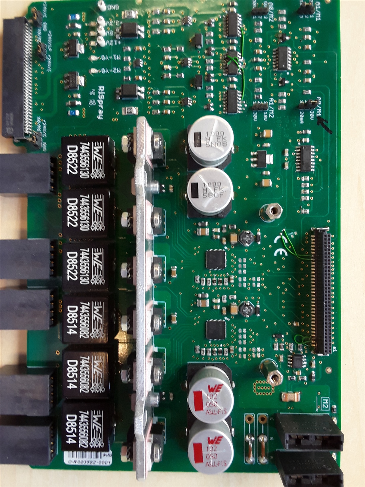

  • Hello Cole,
    I got an update from the customer and to make sure I will not miss any, I will just paste the response below:
    "You comments about the feature:
    We've heard this kind of operation time and time again from other users and we want to accommodate their requests. While none of the current generation parts have this feature, we know that a future generation will.
    For the first installations we can place an extra magnetic brake on the motor, but for the future it would be nice if footprint is the same as the current IC.
    I have added a photo of the proto pcb with twice the DRV8323RS, so we can put the new IC on the same PCB only SPI program extension:
    Then we can cancel the extra magnetic brake in the future on the same PCB, that would be nice."
