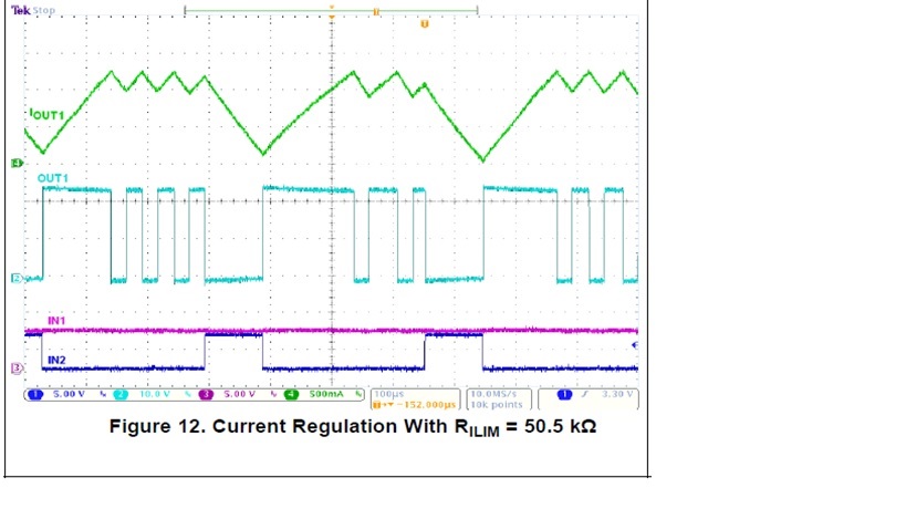

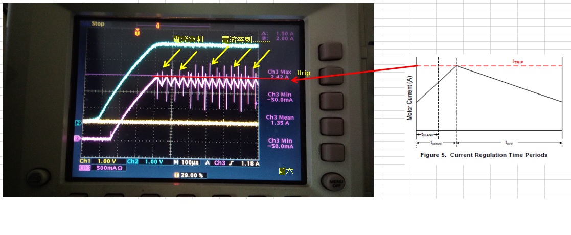

Hi Sir,
DRV8871 EVM o/p current as below,
We measure current as below,
CH1:IN1
CH2:IN2
CH3: Motor o/p current
It looks some overshoot/undershoot on it, is make sense?
How to reduce these overshoot/undershoot?
Thanks Ian.

A common way to suppress against these spikes is to add a varistor or TVS diode across the outputs to suppress the high output voltage spikes.
Ian,
Looking at the current waveforms a bit closer, I think the spikes can be an artifact of the current probe used to measure the current. The current through an inductive load shouldn't change so suddenly as shown in the waveforms. Can you try measuring the output voltage at the terminal where the current probe is measuring the current. If there are no voltage spikes in the voltage, it can suggest that the current spikes are the artifact of the current probe.
