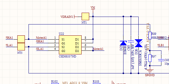

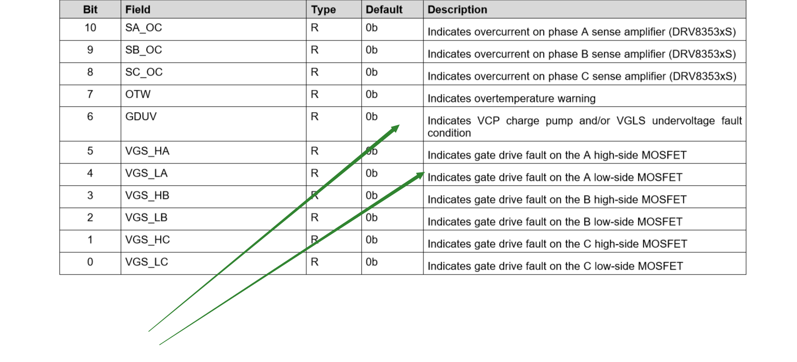

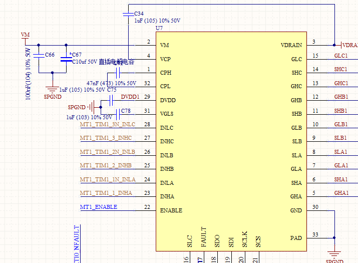

      We developed a three-phase motor drive board ,using chip DRV8350Rs.When we do quick start stop(300ms) experiment. Motor 2 and 3 didn't work and the capacitance of the power VM is burned. It senms like that  the chip didn‘t work and report nfault.It is strange that  the motor 1 works excellently while the diagram of them is same.After change some capacitance  and diode , we found that the VGLS and GLX is internally short-ciruit when the Drv8350 report fault like the green arrrow indicated in the picture.
I wonder that why the motor 2 and 3 can't work like motor 1 and it is the same reason that the VGLS and GLX is short and motor can't with heating capacitance.
pleast check the diagram and fault report.

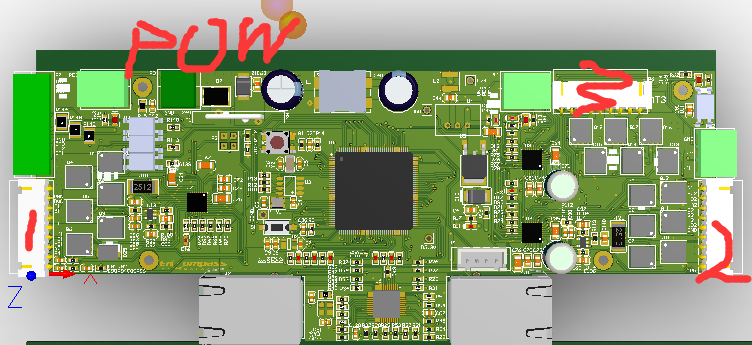

    My first impressions lean towards layout. Can you confirm the locations of the internal short by taking a Digital Multi-meter and using the impedance test between the two pins you think are internally shorted?
    Gate Drive faults on Low-side A means that the GLA would be shorted to GND, or VGLS. Where GDUV means that VGLS or VCP is shorted to GND, VDRAIN, or VM.
    The reason I think that layout is the problem relates to what you've told me so far. I am assuming you:
    • Kept the schematic the same between Motor 1, 2, and 3 (as you've mentioned)
    • Used the same group of devices from the same tube or reel
    • Used very similar motors for 1, 2, and 3 that require similar voltage and power
    The only differences are:
    • layout between Motors 1, 2, and 3
      • Layout of Motor 1 does look much better. More area devoted to phase and FET nodes and the gate paths look much more symmetrical
    • Both DRV8350's for Motor 2, and 3 were damaged before driving the motor, and the DRV8350 was not
      • This is unlikely, but can test this by desoldering the DRV8350 used for motor 1, soldering it in place of motor 2 or motor 3, and repeating the experiment. If the motor runs in motor 2 or 3, then the devices were at fault
    • Something in the sensing path for Motor 2 and 3 were damaged or different which then contributed to incorrect commutation
    • This is also unlikely as we have plenty of protection features that will attempt to stop incorrect commutation
    -Cole

            The short location is pin 31 VGLS and pin15 GLC of all damaged drv8350.
             Yes,  I also think the gate path of MT1 is better.But because of the sides of board ,I have no space  to make its area bigger.So
    how I can improve the 2 and 3  to make it perform like 1?

           AND I  found that there will be -3V (some time bigger) in SLC  occasionally. i thinks there must be some problem in the layout which caused this problem .Can you leave your email address and I send my pcb project to you .And then we can discuss way to solve it.
