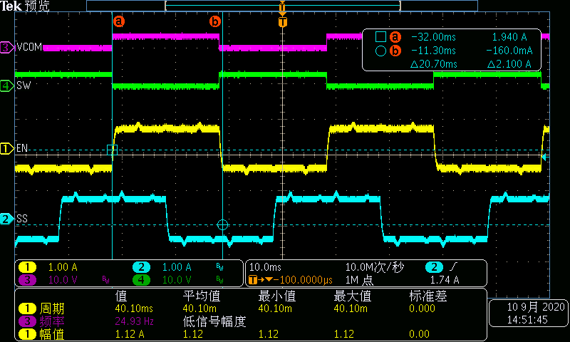

    3. Based on my DRV8833C testing, the frequency of AIN1/AIN2 is 25Hz for Full Stepping with the starting speed. However, I have checked the DRV8833C EVM User Guide, and it states the motor starting speed is 100pps=100Hz at full micro-step. Am I testing incorrectly?

    3. Each STEP means each motor movement. A step motor has two windings. Any winding current changing could result a motor movement. How many AIN1 and AIN2 combination changes are in one AIN1 cycle time? According to your test waveform, one AIN1 cycle, AIN1 and AIN2 changes 4 times: Step 1: AIN1=1 AIN2=1; Step 2: AIN1=1, AIN2=0; Step 3: AIN1=0, AIN2=0; Step 4: AIN1=0, AIN2=1.
    So, STEP frequency is 4 times higher than AIN1 frequency.
