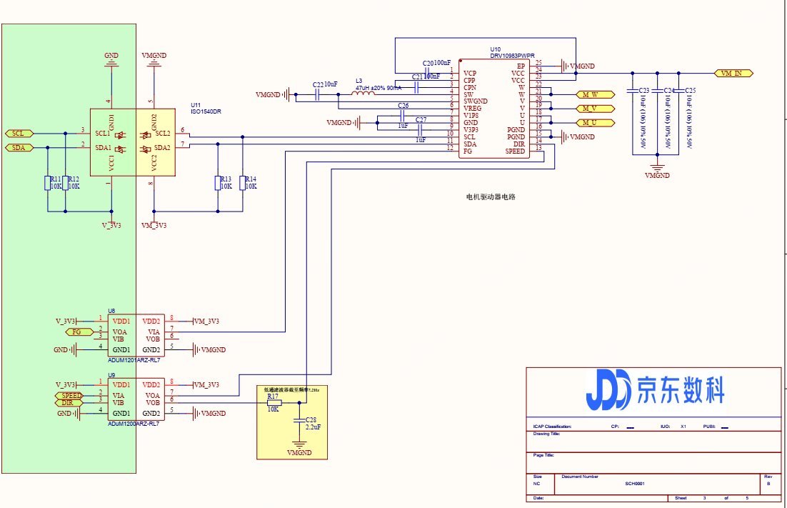

Our application is DRV10983PWPR for commercial service robot to drive the head rotation, the motor is powered by 24V, and the brushless battery is a common three-wire model with no hall and no encoder. At present, there is a problem that the motor torque is too small at low speed. The specific hardware and software configuration is as follows.

    2.A. When 0x27 = F8, Mechanical AVS is disabled and when 0x27 = F4  Mechanical AVS is enabled. Inductive AVS is not functional in DRV10983 so we recommend to set this bit to 0. When mechanical AVS is enabled, the device checks if the BEMF voltage generated by the motor is greater than the voltage that is applied to the motor. If this condition is true, device accelerates the motor speed by increasing the output voltage such that the resulting output voltage is greater than the BEMF voltage of the motor.  When 0x27=F4, mechanical AVS is disabled, so you don't see motor accelerate. Device calculates the minimum output voltage based on the programmed BEMF constant Kt. Can you measure Kt and see if the measured value is same as programmed value? Here is the video that explains on how to measure Kt using the lab oscilloscope.
    Please refer to section 8.4.8.1 in the datasheet for more details.
    2.B. Can you read the fault register and see what fault gets triggered when you set the speed command to 0x20?
    2.C. This device does not have feedback loops to regulate speed and torque. This device is suited for applications where the load torque does not change dynamically. This device internally measures phase current to estimate the BEMF voltage and BEMF zero crossing. Commutation is done based on the BEMF zero crossing estimation. Unlike FOC which has a torque loop, this device does not have the capability to regulate output torque. However, speed control is possible using an external MCU. An external MCU can be used to measure the motor speed and a PI controller can be implemented in the firmware to regulate the speed of the motor. Please refer to this reference design for more details.
