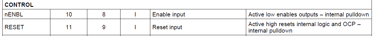

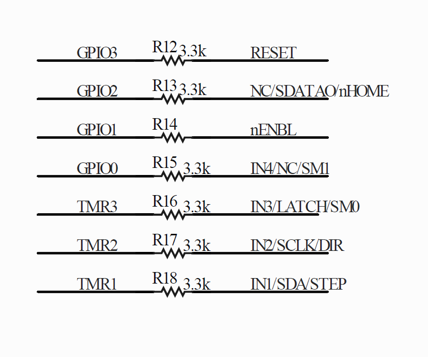

I am currently trying to drive a solenoid (1.2W max/ 24V power supply) using the DRV8803EVM with PWM inputs generated from the TM4C1294XL Launchpad.
My problem right now is generating the PWM input from the pins on the TM4C1294XL Launchpad to the input pins on the DRV8803EVM board.
I am producing a PWM wave when I go and look on the scope at my pins but it is not triggering any sort of output on the DRV8803EVM board. I want to be able to switch between two outputs (OUT1 and OUT2) on the EVM board to power two solenoids (1.2W max/ 24V power supply) but I don't think my PWM is correct when triggering an output from the DRV8803 when I attach my PWM pins on the TM4C1294XL Launchpad to the input pins on the EVM board. I am not sure if I don't have the correct frequency or amplitude or what?
For reference, I don't want to use the onboard MCU on the DRV8803 to complete my project because there is another input coming from the TM4C1294XL Launchpad that will be integrated into the code later (not by me).
My code is below for reference.
