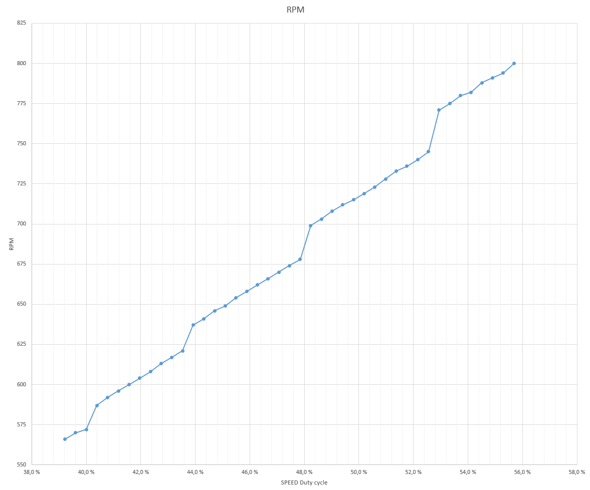

We are using an DRV10983PWP motor driver in a product. The motor speed is controlled by PWM. The PWM frequency is 31.5kHz.
When increasing the PWM duty cycle with constant small steps the motor RPM occasionally makes a much larger step. The occasional larger steps can be seen in the attached image. The large steps always happen at the same duty cycle.
Is this normal behavior for this motor driver or could there be something wrong with our settings?
