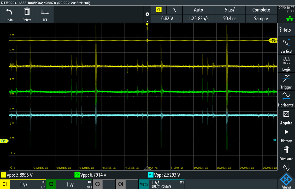

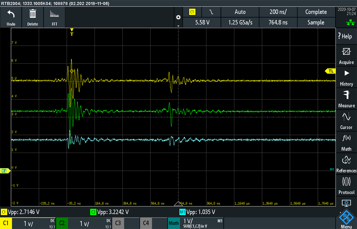

    I will post the question as resolved as I am pretty confident this will help. But I wanted to ask one more question and show you a couple of snapshots of what the output of the 5.0 and 3.3V look like.
    I can measure the output of the Buck built into the DRV8301 but it's not as easy because I had not anticipated that it would be useful. Note that at this time I am not positive that the issue is caused by the 5.0V or 3.3V or both. I suspect the 5.0V at the very least based on the behavior of the encoder, where communication is not only altered but the encoder also enters reset state, probably because of an error on its power supply. The 3.3V line is used to power the two MCU's and I have yet to experience reset of either MCU's but they might just be a little more tolerant than the encoder, that being said the communication is also altered, although not as much as than the MCU/Encoder communication. I suspect both regulators are affected, and if the output of the buck on the DRV8301 isn't clean, these 2 regulators are not off to a good start.
    Questions:
    - Is the strategy of setting the buck output to ~ 5.5V, and then regulating down to 5.0V a good strategy? The optical encoder requires both 3.3 and 5.0, and the stability of the 5.0 was critical since it powers the LED. Or would you deem this strategy unnecessary and drop the 5.0V regulator and adjust the buck to output 5.0V instead?
    - Outside of the different packages between the DRV8301 and the TPS54160, would the suggestions made by Webench directly applicable to DRV8301? Or are there any things to watch for?
    - On the spanshots below, is the excessive ringing a typical sign of improper filtering on the buck converter?
    Snapshots:
    - CH1: output of the 5.0V regulator
    - CH2: output of the 3.3V regulator
    - M1: CH1 - CH2
    The period between the main ripples is roughly 14 us or 71.5KHz which is my PWM frequency (I have tried lowering down to ~ 18KHz, which helped with noise but it did not fix resets nor bad communications between MCU's and encoder).
    The first snapshot (zoomed in) shows there is a bit of higher frequency (than the PWM frequency) as well.
    There is a quite a bit of ringing, which tells filtering may not be tuned in properly.
    Thank you again

  • Hey Stephen,
    Its actually pretty common to do this, buck down from large voltages and then tightly regulate the bucked down voltage for anything related to signal chain and integrity.
    A buck will be used for the large jumps in voltage because its more efficient (from a power losses standpoint) to do this. Then a linear regulator will hold the voltage much more finely than a buck will (because the linear regulator shouldn't be switching). Depending on the regulator's input specification, it might be better to set the buck closer to 5V so the regulator doesn't need to have a "waste more" with the higher voltage drop.
    If the theory doesn't make intuitive sense at first glance, think about power losses of something switching vs. current running through a resistor which represents the buck and linear regulator, respectively.
    Any other suggestions made by Webench directly applicable to DRV8301? Or are there any things to watch for?
    I think the biggest will be how they do the layout and if you want to swap out any components that better suit your application. In general, I encourage you to take a look at what the tool has to offer. You might find something interesting that you want to post a question about to the TPS54160 forum.
    On the snapshots below, is the excessive ringing a typical sign of improper filtering on the buck converter?
    Agreed with your prognosis for the bigger spikes, definitely coming from the motor. Interesting note is the ~600kHz for small 3 in succession pulses, which lines up with Buck frequency. To me, this looks more like issues that can be solved by fixing the grounding.
    As for filtering, I agree filtering could help this but this almost looks like the GND reference is bouncing in this case. So, is the GND bounces where the output filtering cap is located, you'll still see this noise.
    -Cole
