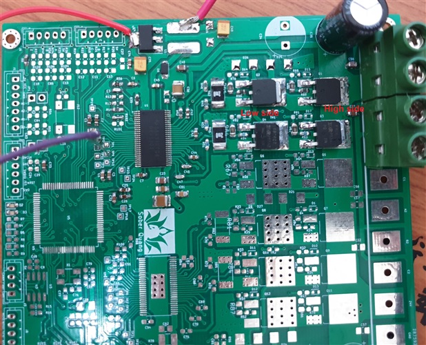

I am designing bldc driver using DRV8302. After I had soldered my PCB, I tested it, It got a problem. The input voltage is 12V.
My current problem is when I turned on power, output voltage on PH pin is about 8V, after few seconds I come back to 5.30V.
I have double checked all component values. but I dont know why is that

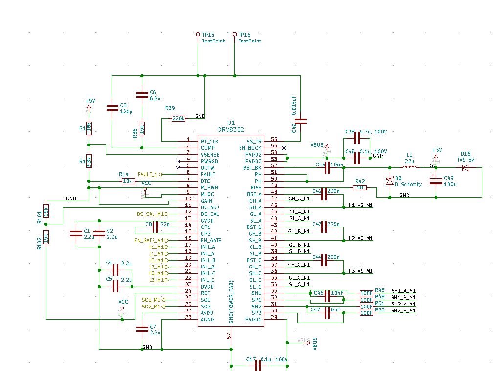

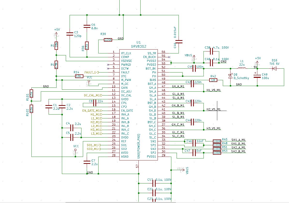

Here is my schematic.
Do you have any idea what I should try?
Thanks in advance.

    I noticed that the values for using the buck are the default ones in the datasheet. There's nothing wrong with defaults, but if you haven't checked out the datasheet for component selection please take a look at component selection sections. In addition, you can simulate transient waveforms stability, see different component selections, and more with the TPS54160 using TI's Webench Power designer tool, just type in the part number at the top of the page https://webench.ti.com/power-designer/switching-regulator
    Without waveforms, its hard to see if we're dealing with. Reminder, the PH pin is supposed to PWM switching node that  between 0V to 12V which goes through LC filter and creates 5V on the +5V node. So if you're measuring DC Voltage with a handheld digital multimeter (DMM) or similar, then the result you've given might make some sense. I recommend an oscilloscope waveform compared against simulations.

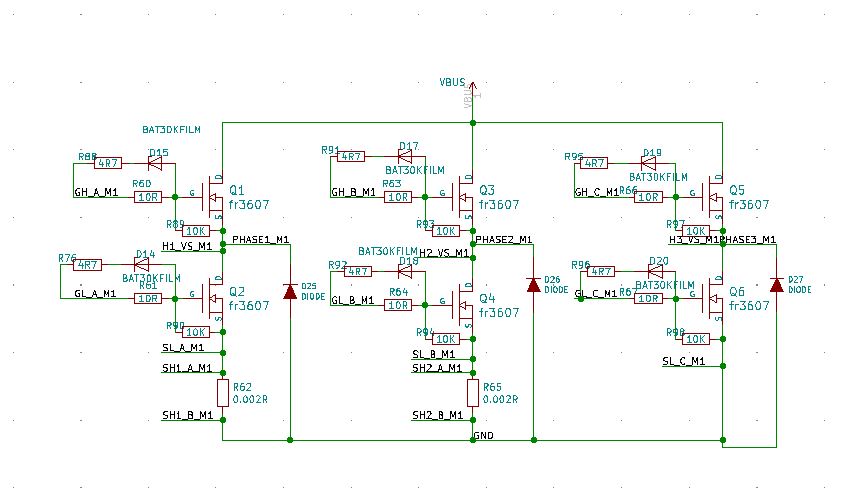

    I want to meet with the team again and see if we can give you some better guidance. In preparation for that, can you also provide the snippet of the schematic relating to the FETs?
    -Cole
  • Hello Cole~
    Thank you for your reply

    The team thinks we're still dealing with assembly issues. Here are key points from the discussion.
    • No waveforms have been provided. Though you have given constant values in text in place of the various waveforms, we haven't evaluated noise, coupling, interference, or any parameter that could help be a clue to the solution to the problem
    • Voltage rating and capacitance on GVDD have verified. We realized the charge pump cap has not been verified, please go verify the ratings (PVDD1*2 = 24*2 = 48V < voltage rating of charge pump cap)
    • The board you have shown is clearly hand assembled. The replacement of the DRV8302 drastically changing the value of GVDD is enough to cause suspicion that this is the problem
      • For context, none of our EVMs have been close to this voltage. If you have an EVM from us, you can check the voltage on the board, then swap the devices from your board to EVM and vice versa. This will be able to see if the problem follows the part or the board.
      • As such, you can try and assemble another board and monitor the voltage, we suggest getting an expert to manufacture it
      • Some more evidence to this is that the vias under the power pad seem a bit larger than expected (we could be wrong about this because only a picture was provided instead of gerbers or suitable layout files). Either way, more solder is needed than expected which means most of the solder will go through the vias and not swell up on the power pad. This has caused issues like this in the past
    • Don't see anything wrong with FET schematic

    1. My solder was not good, especially for DRV8302.
    2. In thermal pad of DRV8302, Via diameter is 1.2mm, and via drill is 0.8. These parameter are so big I think.
    For "I used external 5v power, not use buck converter". I mean I did not use  the buck converter of DRV8302 to make 5V. I used external 5V power supply. Then I connected this 5V supply to my PCB, and my PCB converted down to 3.3V.
    Thank you for your support.
