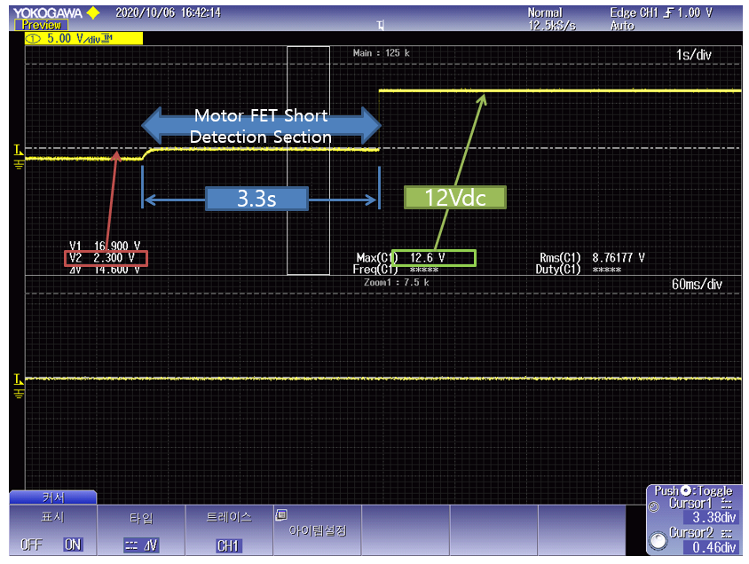

  • Sorry for the late reply.
    Customer deleted motor short detection section (2.3V) and entered 12V.
    See figure.
    Problems can be identified consistently.

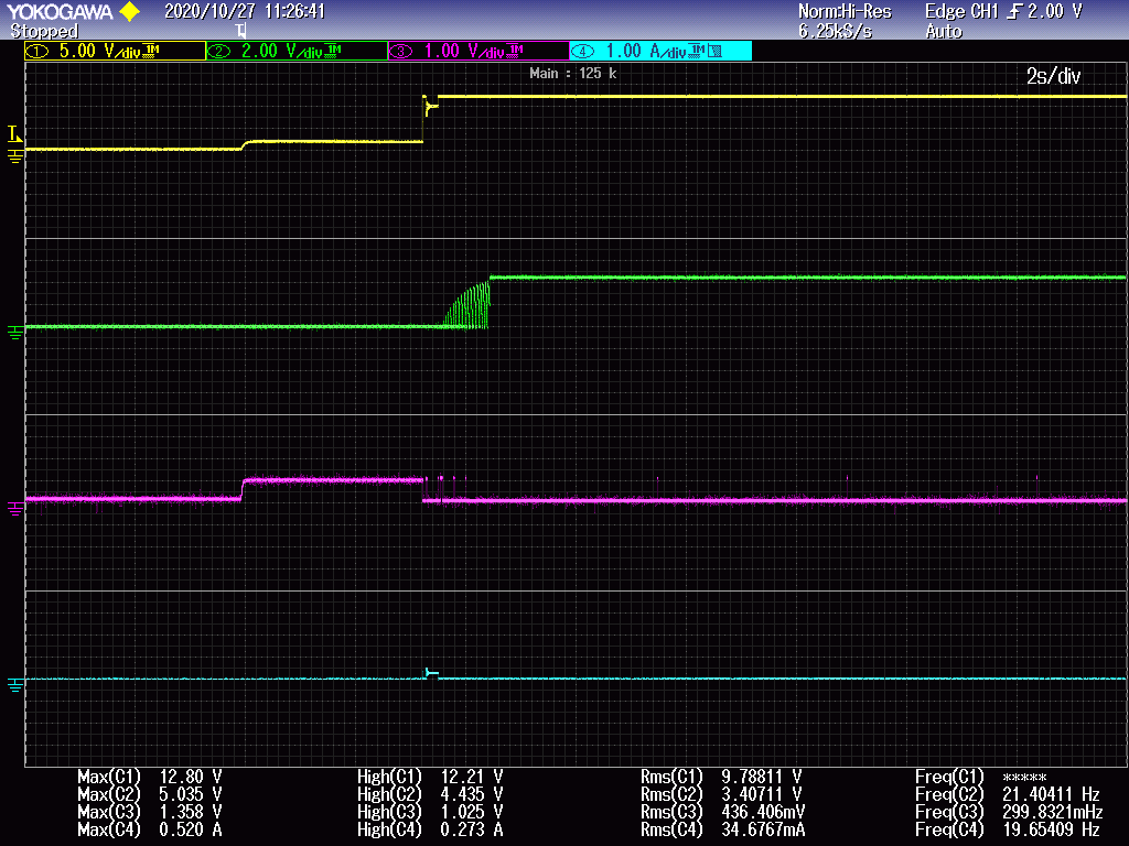

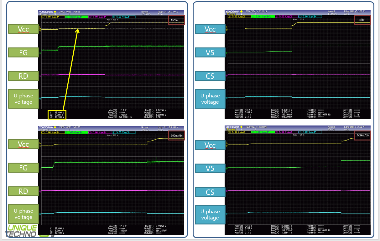

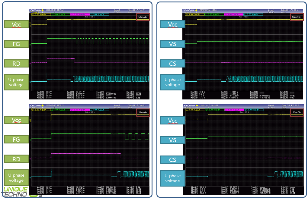

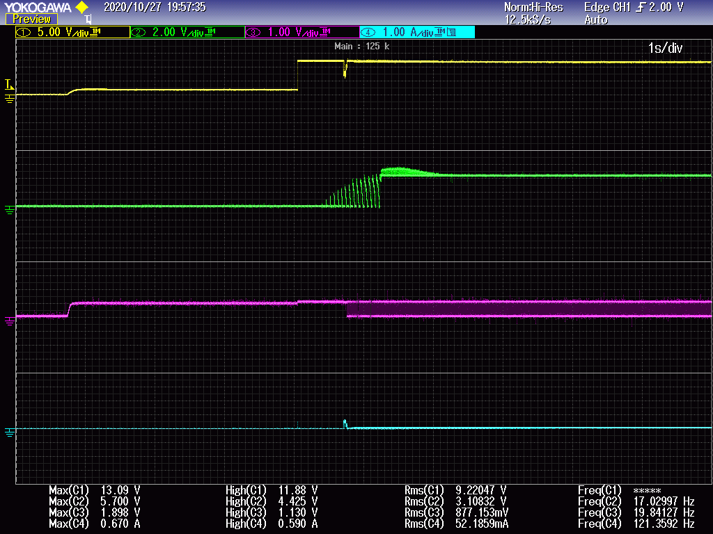

    -> Only the board in question doesn't work. The customer has one more board that doesn't work. The attachment is the remaining one board waveform.
    1) Yellow: Vcc (12V after initial short detection voltage 2.05V)
    2) Green: PWM (Duty 0 to 100% condition for motor soft start for 1 second)
    3) Purple: FG
    4) Sky blue: Current wave shape
    Bad Wavefrom :
    Normal Wavefrom :
