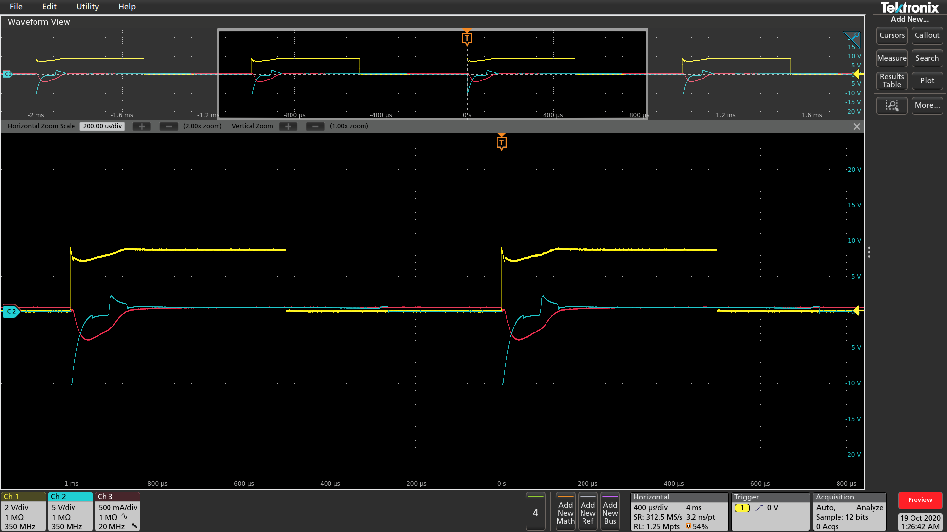

i have an interesting project.

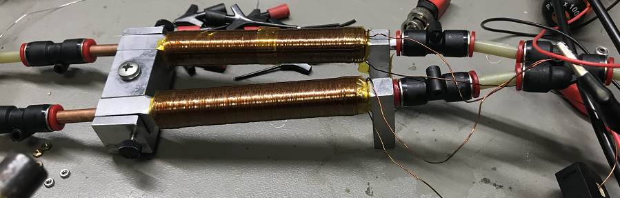

I have 2 18V25 Hbridge from Polulu it has 4 NVMFS5C423NL N mosfets in use for the Hbridge topology.
the first HBridge with the 18V25 has a power supply 2231A-30-3 at 6A at 24V connected and is switching at 50/50 1KHz,10KHz, 100KHz with a le croy awg.
That by hookin up an Inductor (measured with LCR in Series, 18mH  internal resistance of 2Ohm) that there is a lot of inductive kick back at 1KHz,10KHz, and 100KHz.
The maximum current that should run through each coil is 8.36A without free wheel diodes as extra protection.
First Question:
which free wheel diodes would you recommend as extra protection?
Second question:
which protection matters should be taken in place on the circuit board. i have the 24V for the Emagnet connected to a dcdc converter
That bucks the 24V to 5V on which the DRV8701 and the IMXRT1062 are connected to the same ground.

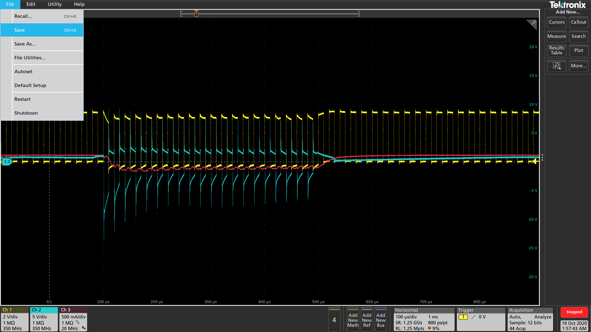

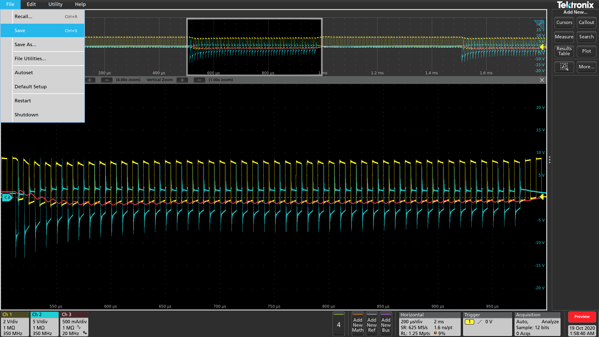

I would like to protect these against negative spikes as you can see. Yellow is the PWM signal 50/50, Red is the Current through one of the Coils, and the Blue is the Kickback, I dont think the MCU is going to like these spikes.

10KHz
third example at 100KHz
  • Hi Bastiaan,
    Thank you for posting to the motor drivers forum.
    1. I suggest using Schottky diodes rated for the maximum current expected through the coils.
    2. The DRV8701 comes with protection features like over-current protection and over-temperature shutdown that disables the H-bridge. To further protect against the voltage spikes, you can add TVS diodes or varistors across the outputs of the H-bridge to limit the voltage spikes.
