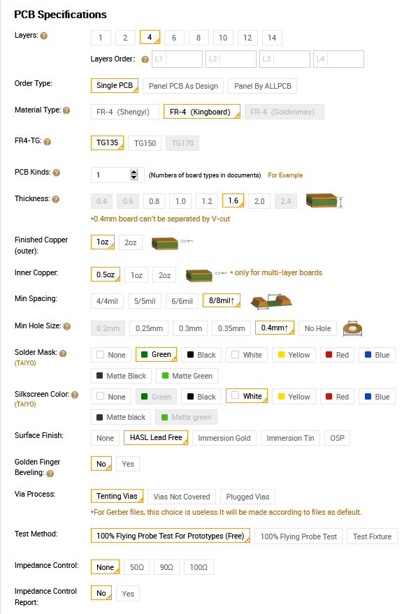

You shared the gerber file of the BOOSTXL-DRV8305EVM. I want to have this product produced with the given gerber file. You have shared various information about production in the PCB file: Stack layer, Colar, Thickness etc. Changing such information for production prevents the system from working? There may be structures that will affect the performance of the system, but what are the concepts that prevent the system from working when it changes? I am sharing two photos below. Does the chan  ge of such structures prevent the system from working?

  • Thank you for your answer. I have a bad english. You gave a very descriptive answer above. In fact, my main goal is to choose a cheaper production feature instead of the selected production properties in the original gerber file of the product. When making this selection, I don't know which selected production features might prevent the system from working. For me, which of the features in the pictures above and the features selected in the original gerber file prevents the system from working.

  • Hello Mucahit,
    I understand, thanks for clarification.
    Here's what I recommend to keep so the system works.
    • Outer copper layers thickness > 1.4 mil (1 oz)
    • Inner copper layer thickness > 1.0 mil (0.5oz < thickness < 1 oz)
    I recommend these because heat dissipation is very important and thicker copper will allow for lower thermal resistance of the board.
    I can't comment on the dielectric thickness. Because we are not too concerned about EMI, it can be as thin as you are comfortable. As you decrease the dielectric, you are also more likely to have manufacturing problems or increase susceptibility to physical stress.
    To my knowledge, you can't save money on solder so no recommendations there.
    In general, main costs for manufacturing are reducing the Bill of Materials (which means reducing the schematic), or making the layout more compact so more boards fit on one panel for the manufacturer. As such, you might be able to reduce cost by stripping the EVM of components you don't want and then doing another layout of the board without those components to make it smaller. Most of the essential components are given in the datasheet to guide you of what's actually needed.
