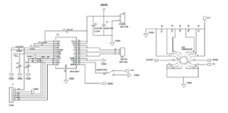

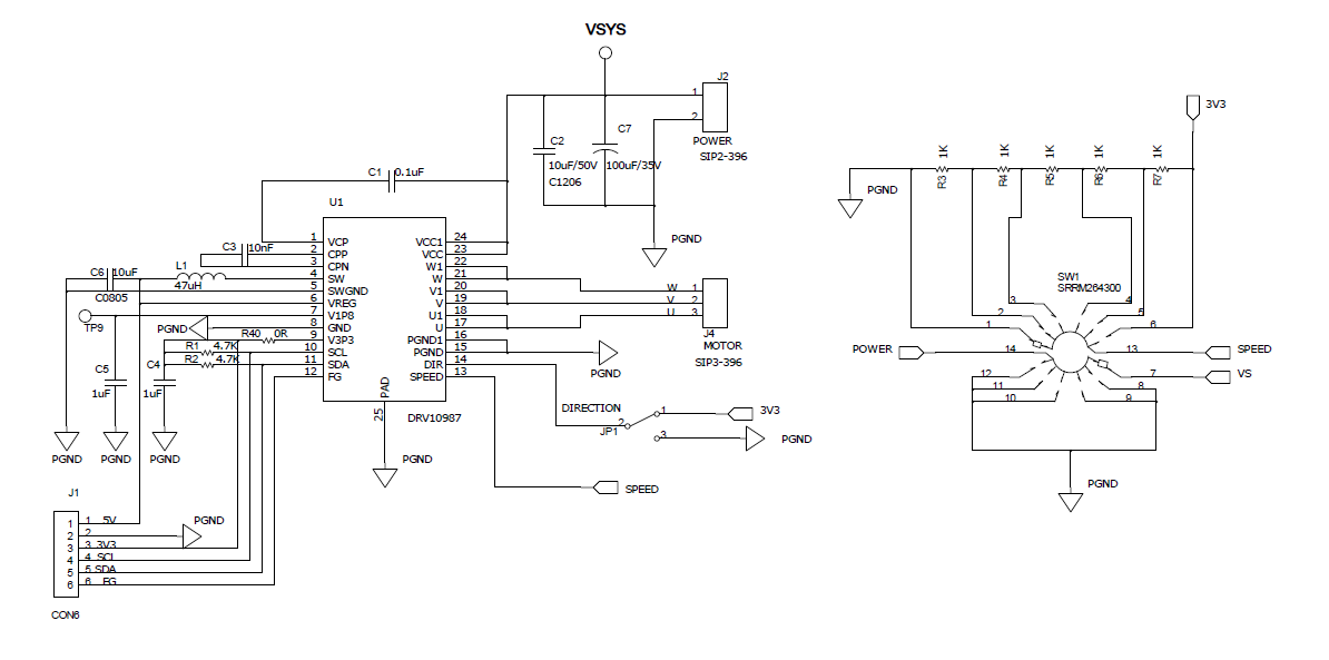

1. Could you please help review the schematic as the attachment?
It looks like the file that was uploaded was very low resolution. Would you please upload a higher resolution one?

Hi Kevin,
Thanks for sharing the schematic. I reviewed the schematic and everything looks good to me. Please let us know if you have anymore questions. If not, then please help us out by clicking the green “This Resolved My Issue” button.

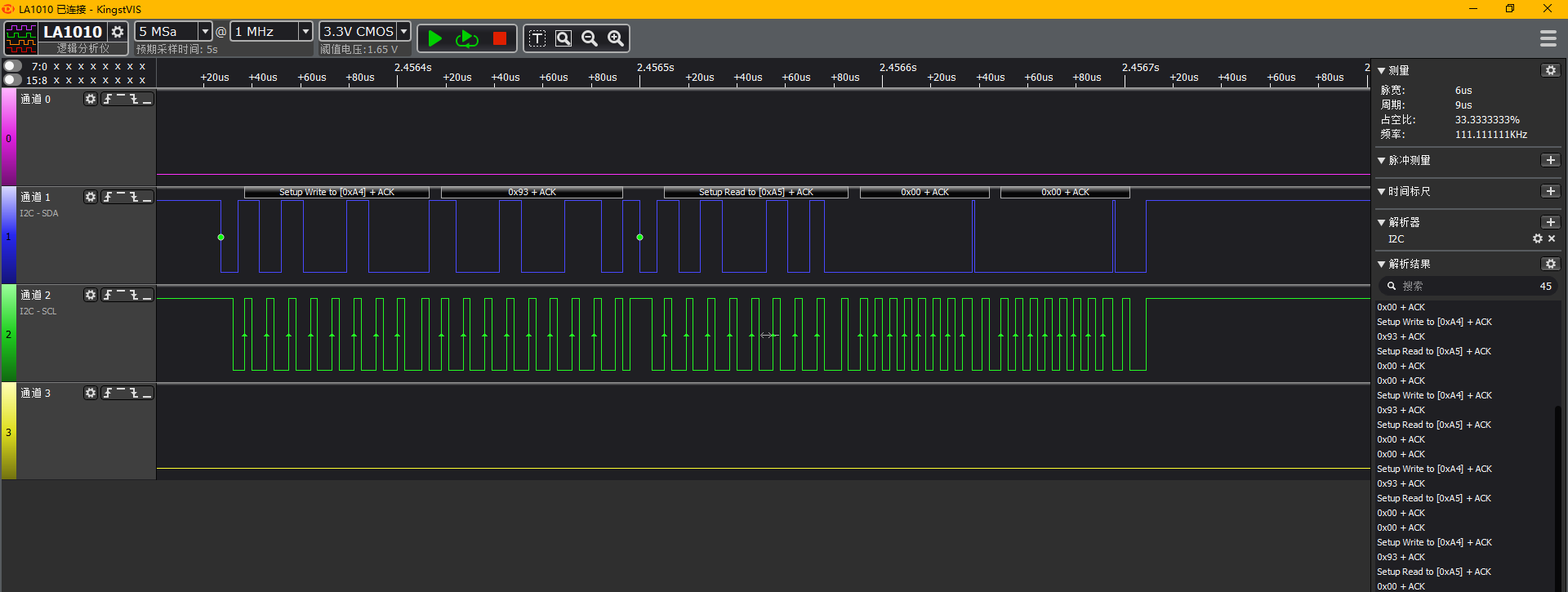

Hi Kevin,
I reviewed the plot and I don't see any issues with respect to the master device sending the command to read data from DRV10987. Do you know what value in 0x93 register is saved in the EEPROM? Can you make sure this is not zero? Also, is your customer reading zero from other EEPROM registers as well?
Vishnu
Hi Vishnu,
Thank you for your reply.
1. The value at 0x93 is 0x3788; 2. Don't change any setting, so it should not be zero; 3. Yes.
It seems that the chip can NOT send out any response. Could you please give me more suggestions about this issue? Thanks.
Kevin Xiong
Hi Kevin,
Here are a few steps that you need to take care of before trying to read/Write from EEPROM.
1. Make sure Vcc is between 6.2 V and 28 V.
2. Write 1 to bit 12 in register address 0x35 (This will allow the device to use shadow registers.I2C read will return the contents of shadow register)
3. Write register 0x31 with 0xC0DE to enable access to EEPROM.
Can you make sure all the above steps are followed before reading the EEPROM?
Vishnu
Hi Vishnu,
Your answer is absolutely correct. Thank you so much! Our customer has a new question. The max power is about 4.8W at present. How to increase the power?
