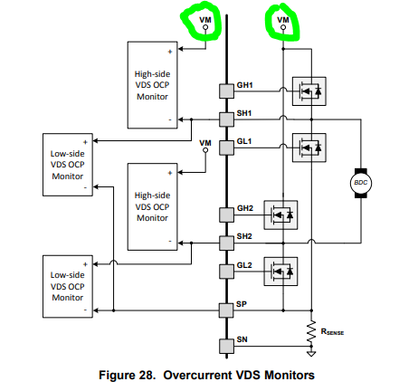

is it possible to have H-bridge voltage higher then power supply voltage on VM pin? We would like to have 60V motor supply and 24V DRV8701 supply. Our idea is to disable OCP, use high side P-channel mosfets controled by N-channel mosfets and a voltage divider on SH1 and SH2 pins. Is it a good solution?

  • Hi Damian,
    Having different power supplies for the device and the H-bridge can cause OCP to not trigger on the HS FETs. The OCP circuitry monitors the VDS of each FET and once it detects the VDS voltage go above 1V for 4.5µs, an OCP fault will be triggered. Below is the block diagram of the OCP circuitry. You can disable the HS VDS OCP monitoring (when using different power supplies) by tying IDRIVE to AVDD as mentioned in Table 6 of the DRV8701 datasheet.
