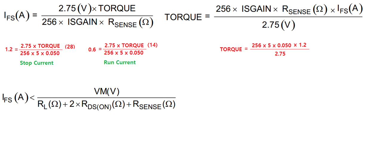

now can control TORQUE Regsistor.
But wanna know How to setpup STOP Current and Run Current.
