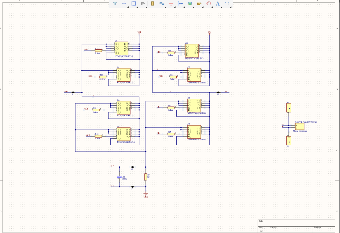

I am using the DRV8701E series and on the assembly, we check that the AVDD and DVDD are generated 4.8V and 3.3V respectively, we then connect a 24V Motor. I am using STM32 to generate the PWM and Direction on the EN and PH pin for DRV but as soon as I connect them the AVDD and DVDD disappear. Even after doing the disconnection, I am not able to get AVDD and DVDD.
I don't see physical damage on the IC so don't know if it's blown internally. I have a full H bridge system and using NTMFS5C628NLT1G MOSFET.. Also my IDrive is selected for 68K setting to AVDD  Is there any fault that I am triggering which is causing this any advice would be very helpful.

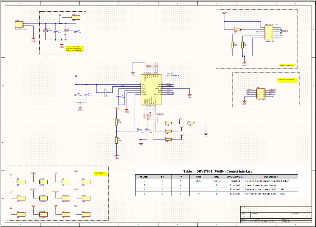

    Can you please share your schematic?
    What is the status of the nSLEEP pin?  It should be high and connected externally to a GPIO on your MCU or to an external source <5.5V.
  • Hi Ryan,
    Thanks for replying back. I am attaching my schematic. My nSleep pin is powered externally to 4.5V for now but in the schematic, it is going to a RJ45 cable which is connected to a micro which will be pulling it high to 3.3V once the driver starts working properly.
  • Naman,
    When the device is in the SLEEP state, AVDD and DVDD will both be zero.  Unless the device is damaged somehow or not getting power from the VM connection, AVDD and DVDD should be as you measured before.  I don't understand how applying PWM/direction commands could cause this to happen.
    Do you have another board you could check out or try replacing the IC?  You can scope the VM, nSLEEP, and nFAULT pin to see if you are getting a fault condition.  You will need to pull nFAULT up to an external supply like your 4.5V supply to ensure it reads properly since it is currently connected to DVDD.
    Also, I noticed you are paralleling FETs at the output.  We recommend isolating the gates of the paralleled FETs with a 10ohm resistor.  I see 0 ohm in there now.
