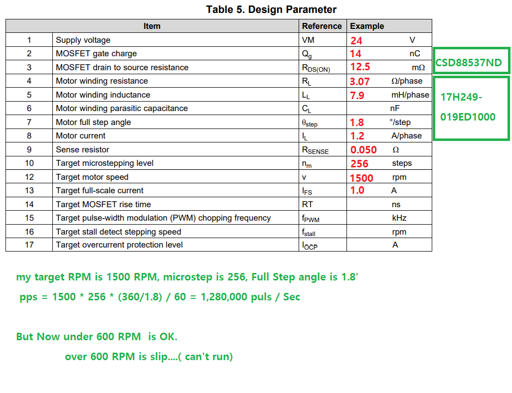

I'm very sorry. last night Can't work ove 600 RPM .
So today I made Table. 5.
Now
CTRL 0x140
TORQUE 0x11C
OFF 0x030 : default
BLANK 0x080 : default
DRIVE 0xA95 : default

Sanghyouk,
Please check the output current. The motor may run too fast. The winding back EMF voltage is proportional to the motor speed and against the input voltage to limit the winding current go up. So, the motor speed cannot work ove 600 RPM.

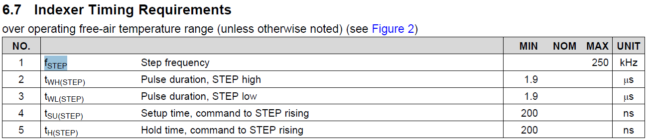

BTW, the first post, RPM and pps calculation is correct. That give >1MHz fstep.
If you can increase the input voltage, that may help.
