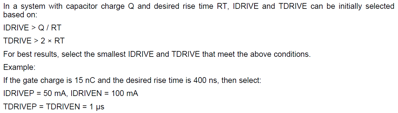

    1. Frist check datasheet "7.3.8 Configuring Predrivers" section to setup IDRIVE and TDRIVE.

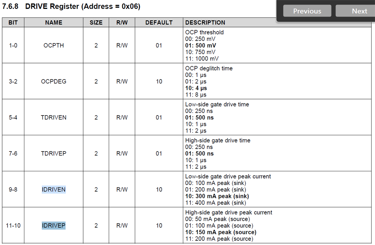

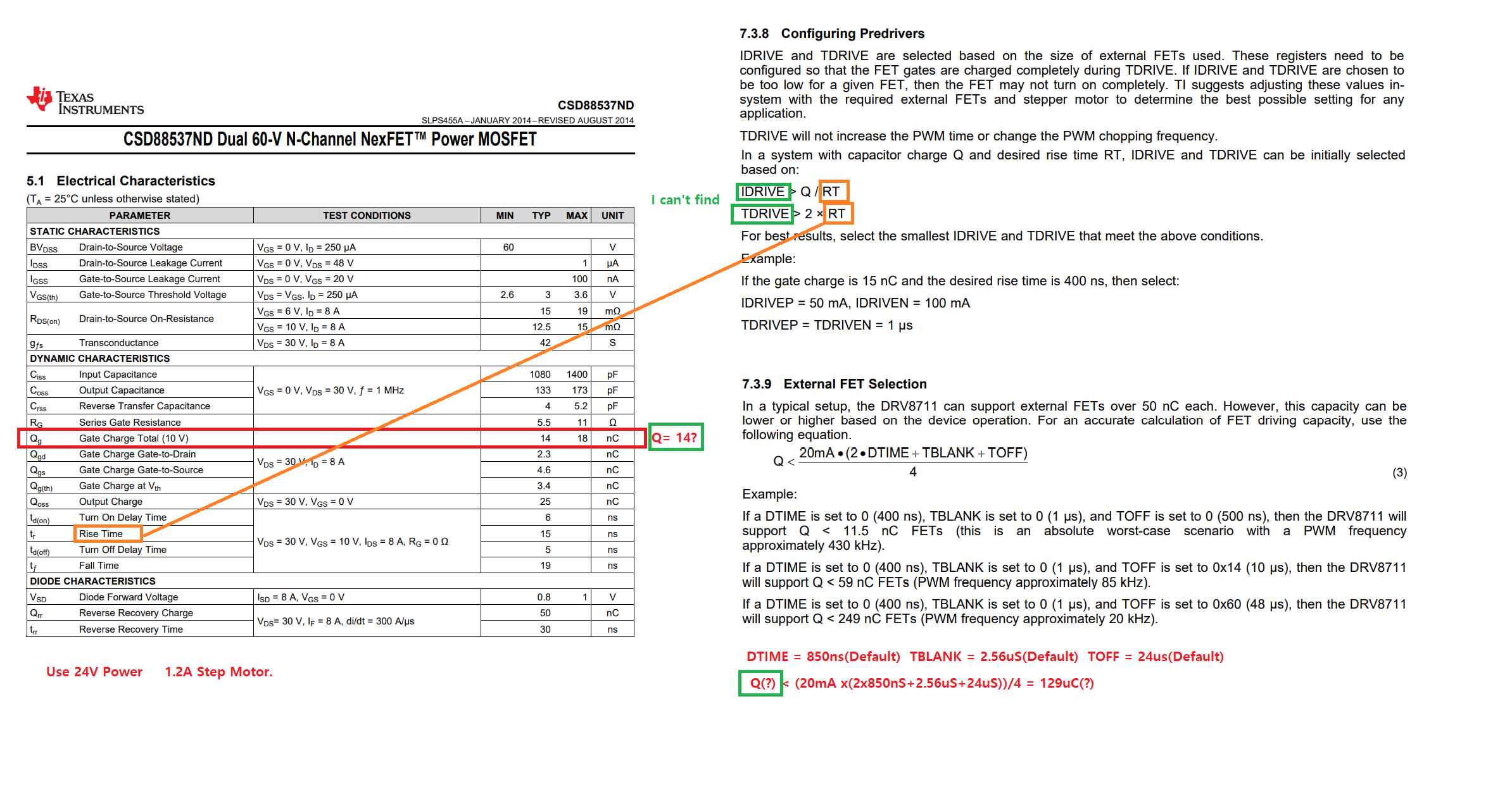

    1. I can't find IDRIVE,  TDRIVE  Value.
       and Q Value & RT Value are right?
    2. Now I make DTIME Set 0, TBLANK Set 0 , TOFF Set 0.  also samle status.
    How Can I do?
    Almost finish. Please help .....

    1. Search "IDRVE" in the datasheet, you can find how to set the IDRIVE and TDRIVE from "Drive Register".
    Q can be found in the FET's datasheet: 18nC for CSD88537. But, TR is desired rise time which is not from the FET's datasheet. It comes from your decision according to the thermal performance or EMI performance. If you don't know it, you can keep the default TDRIVEx.
    2. According to equation (3), you can select DTIME is set to 0 (400 ns), TBLANK is set to 0 (1 μs), and TOFF is set to 0x14 (10 μs), then the DRV8711
    will support CSD88537.
