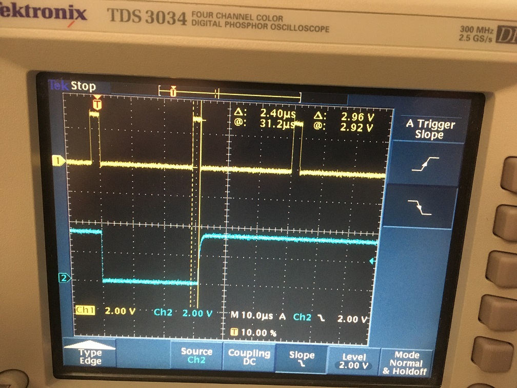

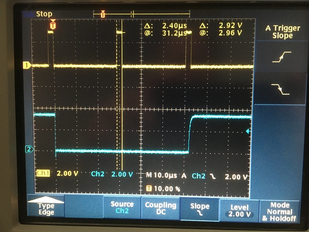

DRV8824: Part is missing step commands at 2.3 us pulse widths.
Part Number: DRV8824
I see the part missing step commands.
This occurs as early as  2.3 us through 2.7 us pulse widths.
This occurs at a frequency of 16 Khz. or 50 Khz.
A motor does not have to be attached - hence no switching noise from the chopper.
I see it by looking at the "Home" position output -
It will regularly output a home pulse that is too long. - missing one or two consecutive pulses.
Can someone explain this timing limitation ?
The spec says 1.9 us.
