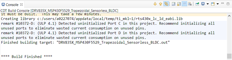

    For sensorless, it compiled and ran on the EVM, first time. While there's some warnings everything works as expected:

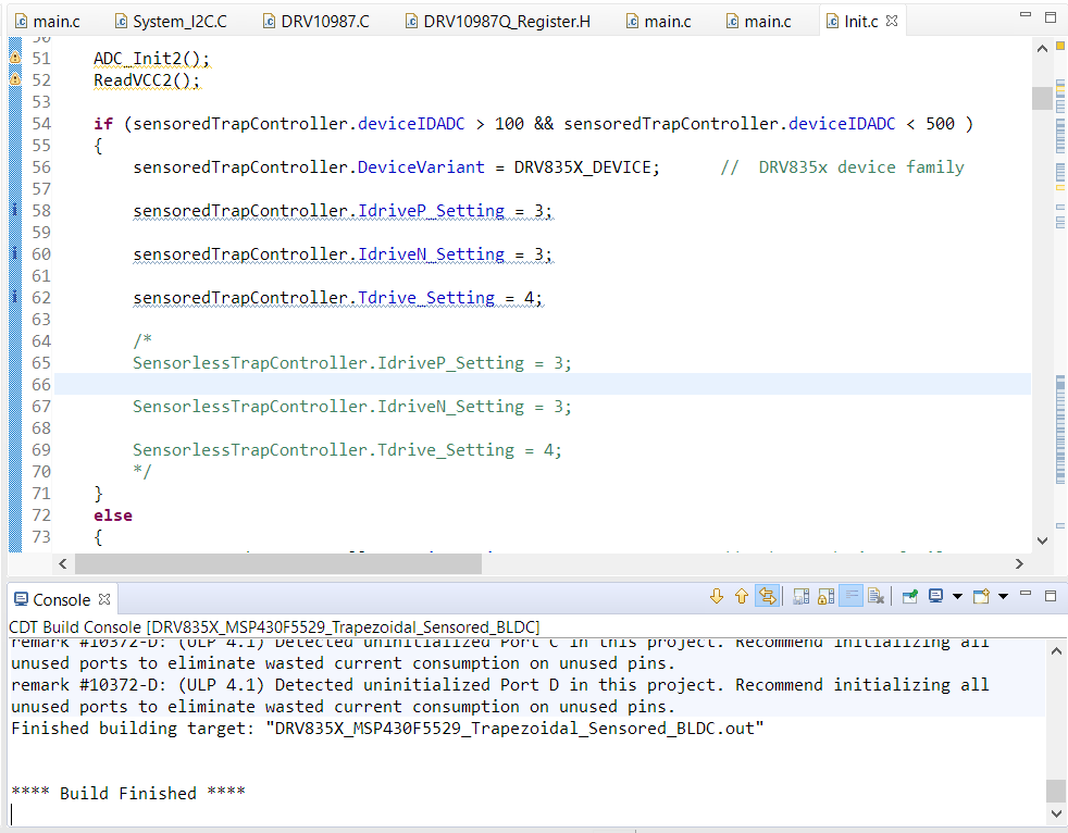

    For sensored, it did not compile for the first time but going into Init.c, it was clear that there was a typo where the SensorlessTrapConfig object was present instead of SensoredTrapController, as you and the post mentioned. Below, I commented the old code and added the SensoredTrapController object for the code and that's all that was need for it to build and run on the EVM.
    I definitely agree, the code didn't build correctly out of the zip file, so that's on us.
