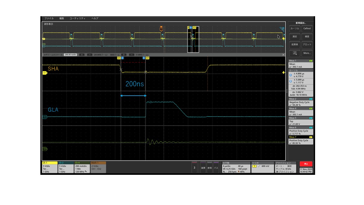

In our boards evaluation, following phenomenon is occurred.
I would like to ask about gate drive of DRV8353HR.
(Phenomenon)
 - If I use PWM frequency 200kHz,  less than duty 5%(lass than high time 250ns) , this driver's gate control was not operated.
 -Even if a fixed Duty PWM signal is input to INHx. Gate Drive on duty seems to slightly change automatically.
(  It is using 3×PWM mode. Since we are doing first evaluation, I am useing with INHA:High, INHB & INHC:Low. I haven't controlled the motor yet.)
(Question)
 - Are there any requirement of minimum on duty cycle of PWM?
 -  I checked GLA and SHA signal, it seems deadtime is 200ns,(Attached file )
    According to the datasheet, gate drive dead time is 100ns(HW device).
    Is this time changed automatically?
 -  Even if a fixed Duty PWM signal is input to INHx(3×PWM mode). Is gate frive on duty cycle slightly change automatically?
     In short, isn't  the current value fixed even with a fixed-duty PWM signal input?

  • Hi
    Ok, I look forward to hearing from you.
    I attached Oscilloscope waveform.
    It is This is SHA and  GLA waveform, The condition is input to INHA at a frequency of 200kHz.
    Best regards
    Naoki

    Gate drive dead time is 100ns(HW device). Is this time changed automatically?
    Small reminder that the dead time value given in the datasheet is the typical value. The real dead time will have some variance. Normally, this would be contained in the min and max specification but its clear that the device was not designed nor tested to specific guardband for the min and max values.
    Not to say that the dead time is uncontrolled, but you should expect a +2.5 times the amount in the datasheet as a maximum (where the minimum is probably closer to 75% of the typical value). These are rules of thumb based on design rules so they cannot be held to the same standard as a number that belongs in the datasheet. Looks like this device specifically falls closer to the maximum expected from the design rules.

  • Hi
    Thank you for answering our questions.
    I want to ask other questions.
    Attached file is waveform movie of INHA(Yellow), SHA(Blue).
    (Green waveform is current waveform. Because IDRIVE is setting 1A/2A, so ringing is occuring)
    Even If MCU is putting fixed on duty cycle into INHA, SHA's on duty cycle is automatically change like attached movie.
    It seems that it is changing approximately ±50ns.
    If input PWM is 200kHz,  the control current value is always varies when the On duty is low.
    It is serious problem for us  when  doing current control.
    Why is this behavior happening?
    According to the datasheet Propagation delay(tPD) time is 200ns.
    Does this time always change?
    Best regards
    Naoki

  • Hello Naoki,
    I understand, yes, the dead time seems to be changing automatically. I've learned that the dead time does not have a minimum or maximum specification and has not been designed nor tested to be tightly controlled. I'm sure if you measured those time individually, they should give you a puesdo-min and max specification.
    I realize this makes your job difficult because we can't accurately derive a maximum duty cycle if the dead time cannot be accurately determined. As such, the typical use case can still be derived with the typical values and you need to account for some error in the real waveform based on your measurements. I will warn you that this is difficult as we expect changes over process and temperature which will, again, prevent you from accurately determining the duty cycle you can guarantee outside of the typical use case.
    Let me know your thoughts.
    -Cole
