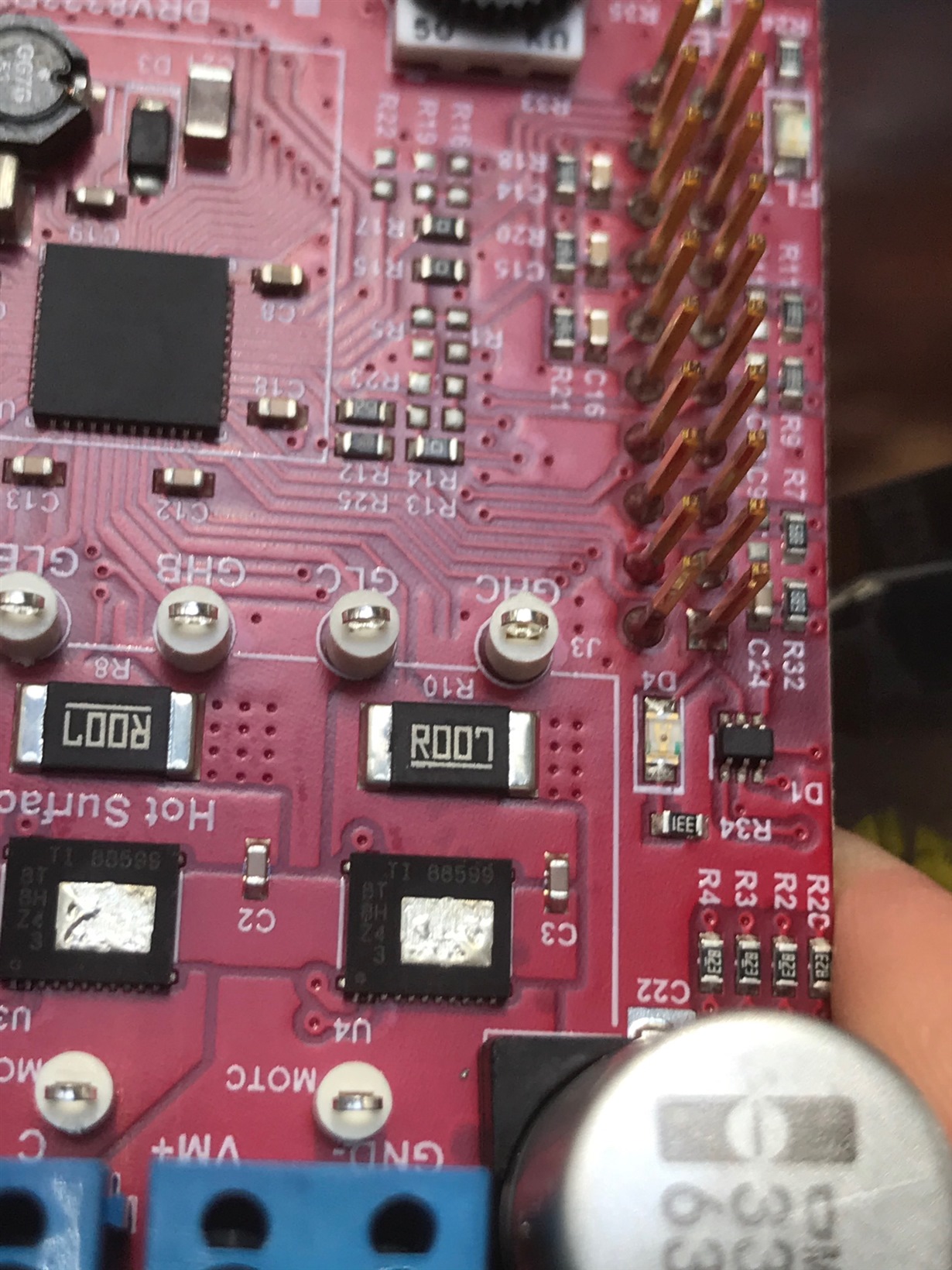

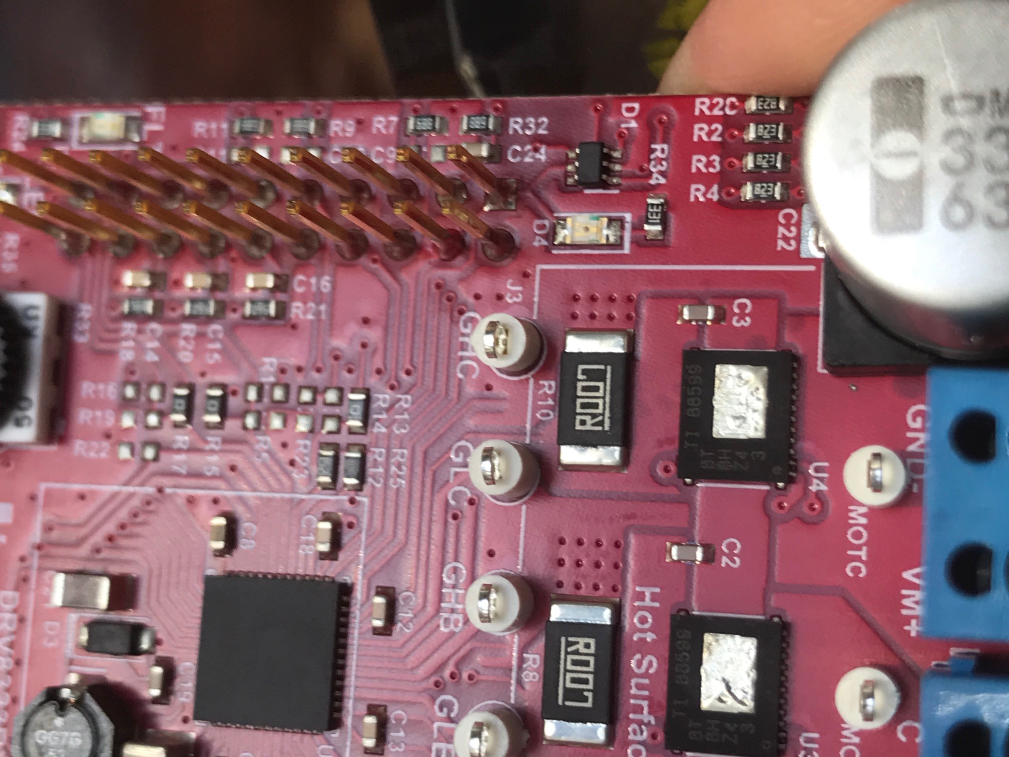

  • Hello Jaden,
    I'm referencing the design files directly as these are the files that are used to manufacture the EVM, specifically the schematic. Also, just took the EVM out of the box and took this picture (you can see 88599 on the top of the package of the FET):
    Don't get me wrong, we need to fix the picture in that user guide to prevent any other confusion. But I hope this helps.
    -Cole
