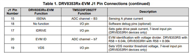

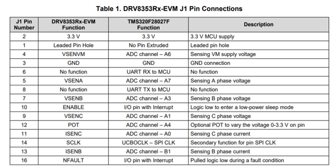

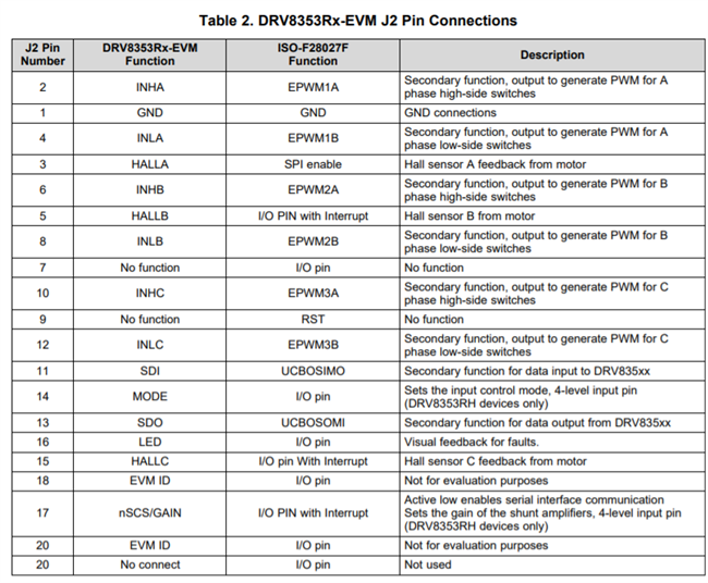

    For now, there's usually a table that explains launch pad connections in the DRV8353EVM user guide. This should give the MSP or C2k functionality as well as the DRVx functionality. Using that, you should be able to cross-reference the nodes with applicable ones on the F28069M. Try Table 1 and Table 2 specifically: https://www.ti.com/lit/ug/slvub79a/slvub79a.pdf
    -Cole
  • Hello Art,
    Actually, the answer is sufficient above. I've copied and pasted the tables below for your reference here.
    We expect users to implement their own FW by this point so feel free to ask C2k about any questions in regard to the peripherals and let us know if you don't understand the purpose of any of the DRVx columns on the launch pad.
    -Cole

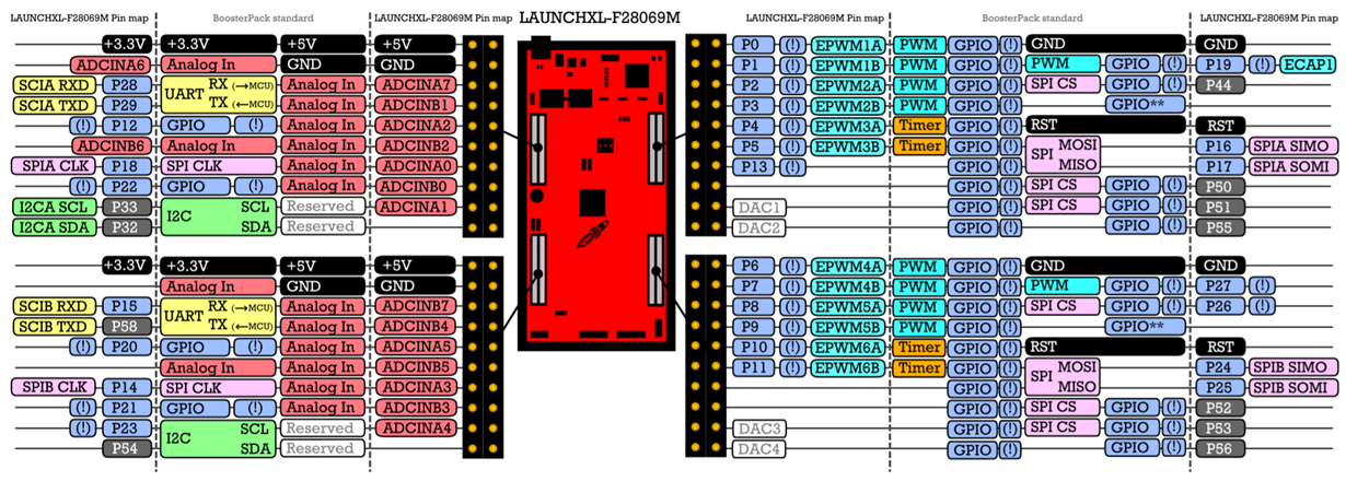

  • Hello Art,
    Yes, no major rewiring. Note, some of the launchpads have DAC outputs that can control the voltage on the HW input pins (VDS, MODE, etc) and this launchpad doesn't have that so be sure to change the resistor values directly on the board instead of writing FW to control the voltage on those pins.
    Here's the F28069M launchpad pin out for your quick reference.
