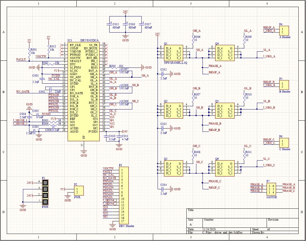

I am trying to build a BLDC motor controller with the DRV8302, and have generally followed the typical application schematic on page 21 of the datasheet (aside from some mode settings). My motor runs at 24V, but even when I power the driver between 8-10V, with a 5V reference, I experience a fault on the nFAULT pin. While the nOCTW stays high, I noticed that the chip feels hot. Furthermore, my supply tells me that the chip is drawing 0.16A, but the typical rating seems to be 0.015A. I am unsure if this is because there is a load connected on the gate drive output, or if this is related to the fault. I have also checked all the VDD's to verify their values.
Are there any pointers as to what the issue may be?
I have attached my schematic below.
Thank you!

  • Hi Cole,
    Thanks for the quick response! I assembled the board myself, and was also unsure about how good some of the connections were. I will see if I can remove the part and add more solder paste to the pad.
    I've reattached a picture of the schematic here.
    Thanks for all of the help! After checking the thermal pad connection, I'll take a look at some of the waveform.
    Robby
  • Hello Robby,
    Nothing looks out of place on the schematic.

    However, I am still getting a fault with these phenomenons. The chip is drawing 2.3mA from my power supply at 9V. The fault pin is high when I pull down the enable pin and is LOW when I set enable to HIGH.
    I am wondering if both PVDD2 and PVDD1 pin need to be connected to the supply voltage to avoid a fault to happen. Currently, we leave PVDD2 floating on our board because we are not using the Buck converter at all.
    Other than that, I don't really know why would I keep getting a fault.

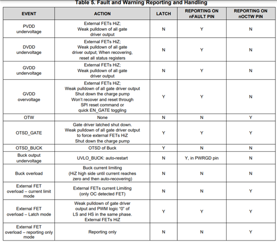

    You'll notice the fault table below. My recommendation is to go one by one with an oscilloscope and monitor the voltage to see they are what you expect with no noise. If you find one that seems abnormal, use a DMM and try to use a continuity from the pin (not the trace) to a component it is connected to. This happens quite often during solder rework where one pin doesn't get good contact and it'll trigger a UVLO fault of some sort because the pin isn't connected to the capacitor..
    PVDD2 belongs to a complete separate die within the device and the PVDD's aren't tied together with a bond wire so you can consider all of the buck pins to be a completely separate device within the same package. That means no PVDD2 will not result in a PVDD fault.
