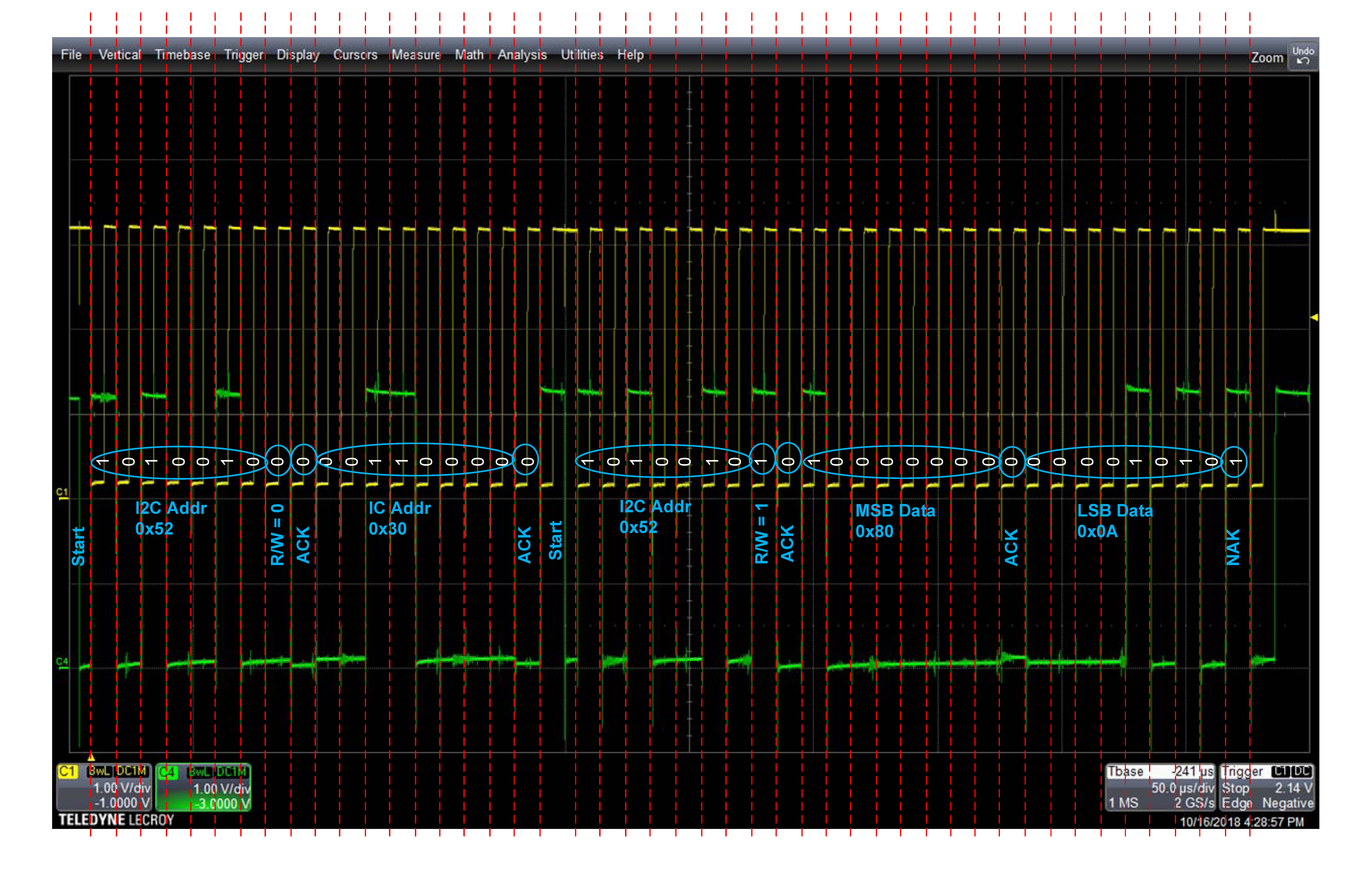

So I followed 'I2C serial interface' of datasheet and some test result waveform in this forum (e2e.ti.com/.../737265
But basically, both I2C protocols are different so I'm still confusing.

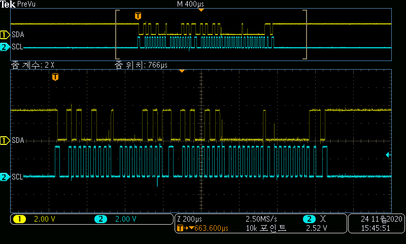

Here is my code & oscilloscope waveform.
Please let me know which mistake I did.

    For now, please disregard the protocol and packet structure you've developed for the DRV10983. The DRV10987 uses the packet structure that you've shown from the datasheet. I suggest you try to exact match the waveform you have reference. For example, the Main (formerly known as master) is clearly stretching the clock after the I2C start has been triggered which is not what the picture above shows. For your information, clock stretching is something that is implemented by the Secondary (formerly known as slave) device.
