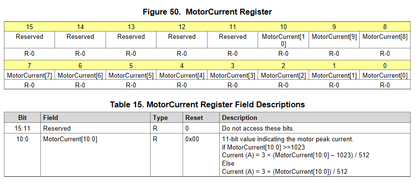

I am currently testing the DRV10987 for suitability for our application. I have the chip in operation with the MCU to the point where a motor is rotating.
Now I want to optimize the parameters and want to read out the registers. Unfortunately, I do not yet understand how the motor current should be calculated. According to the measurement with current clamp 660 mA pk-pk flow in each phase, the value of the register for the motor current is 0x0413 (). How can I calculate the motor current from this? The description in the data sheet (Rev. C) is not quite conclusive:

  • Hello Franz,
    Let's use the values provided as an example. Assuming the MotorCurrent register was read a produced a value of 0x0413, we are given an equation below:
    • If MotorCurrent[10:0] >= 1023
      • Peak Current (A) = 3*(MotorCurrent[10:0] - 1023) / 512
    • Else
      • Peak Current (A) = 3*(MotorCurrent[10:0]) / 512
    So we need to convert MotorCurrent from a hex value to a decimal value to see where it lines up. 0x413 = 1043 which is >= 1023. This means, we use the top equation.
    • = 3*((1043) - 1023) / 512
    • = 0.117 A
    • = 117 mA (peak)
    Assuming 660mA is peak to peak and the current looks very sinusoidal (with little distortion), 330mA peak measured vs. 117mA peak calculated feels a bit too much error. We should expect some error but not this amount.
    Can they provide a picture of the waveform and their motor phase to phase resistance number? And have the tuned lead time (advanced control, lead angle, etc) for their target speed?
    -Cole
