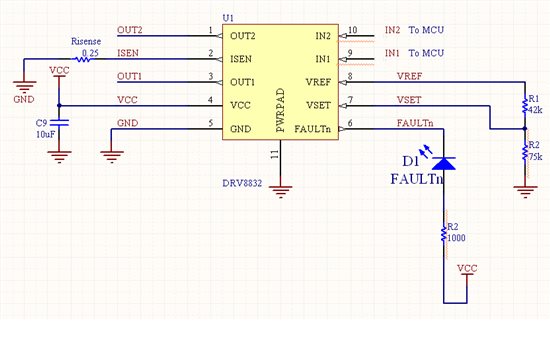

I have a request with DRV8832 motor drivers. Can someone publish a typical application (schematic) of DRV8832 motor driver for 3.3V DC motors?
I am working on a robot project where i would like to control dc motors with pulses with modulation (through MSP430 MCU).
Akos
  • In 8832 the output voltage is determined by the voltage at the pin : VSET. You cannot PWM the input pins IN1 and IN2 very fast.
    You could PWM the voltage at the VSET pin (using a RC filter).
    For constant speed applications, you can set VSET with resp. to VREF. If you want to change the speed, you'd have to drive the VSET using a DAC. (or use DRV8830 & I2C to set VSET).
    I am assuming its a constant speed application, here's a rough schematic (using 8832):
    Vref output voltage  = 1.285V (typical)
    This implies: Vset  = 0.825 and the Voltage difference between OUT1 and OUT2 will be 0.825*4 = 3.3V
    The output state of the OUT1 and OUT2 will be given by table 2 here: http://focus.ti.com/lit/ds/symlink/drv8832.pdf
    Vivek Shankar

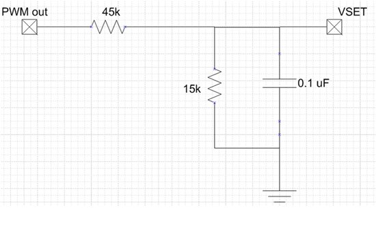

  • If you really have to PWM (and cannot use the DAC in the MCU), you can use this configuration: MCU -> PWM -> RC Filter -> VSET
    RC value will depends on PWM frequency, normally, above audible frequency (20k) is recommended, higher frequency will be easy to select RC filter to filter PWM. This frequency will not affect DRV8832 and external circuit efficiency.
    Motor Speed (8832 output voltage) will depends on PWM duty cycle. Keep in mind DRV8832 output voltage is equal with 4 times Vset value.
    Here's a sample schematic with 5V PWM output:
    The resistor divider will ensure that a 5V signal gets transformed into a 1.25V signal. RC filter time constant for this particular combination would be 1.13 ms. If you need the Vset voltage to change faster than that, you could play with the R and C values. Make sure the ripple is very less (<20 mV) at the filter output.
    Vivek
