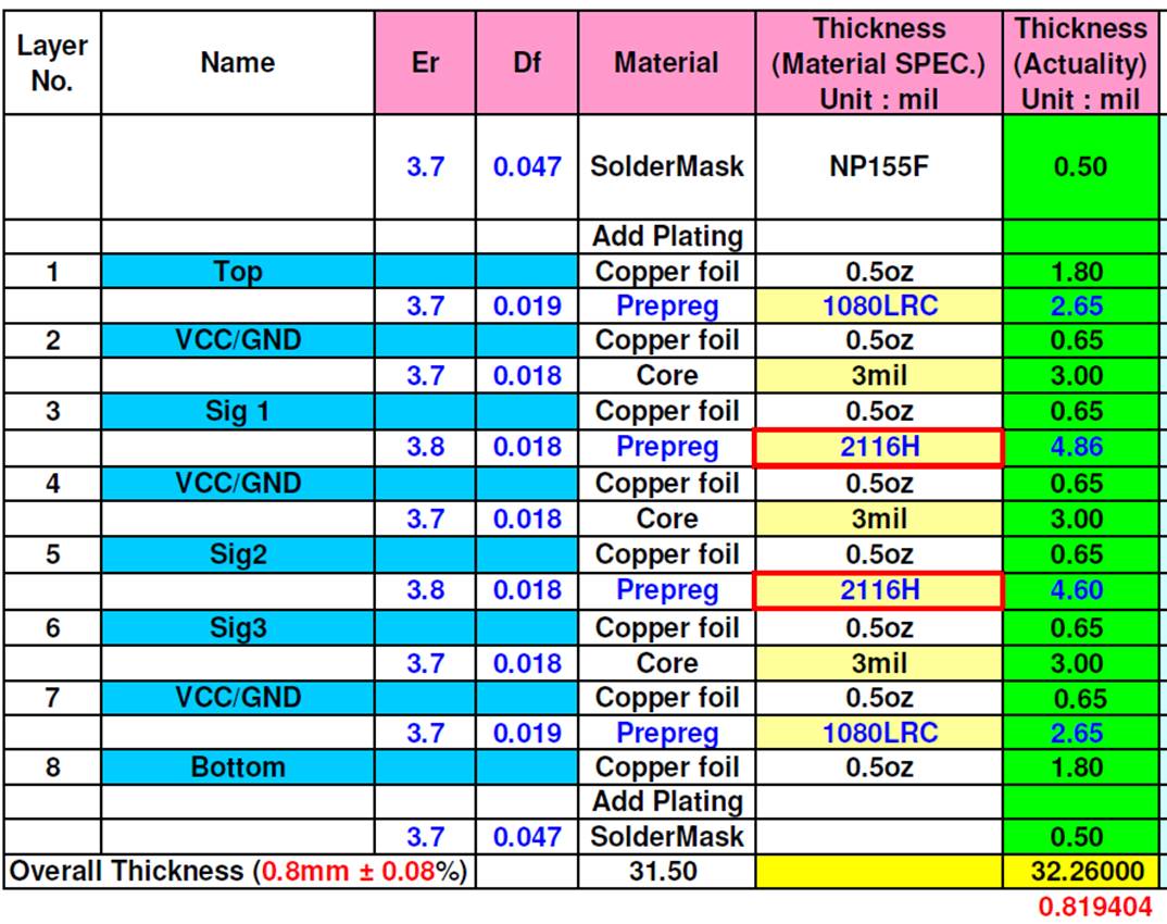

The definition of the PCB layer type only have 2 layer and 4 layer with copper thickness 1-OZ and 2-OZ.
The customer are going to use 8 layer with 0.5-OZ, please reference their layer spec as below.
Is there any stackup limitation on our device? or is there any concern to use 8 layer with 0.5-OZ? Thank you.
