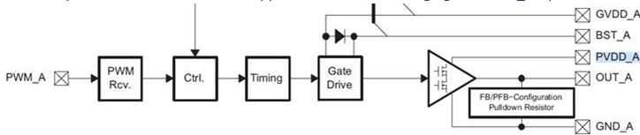

    4. How exactly that driver works ? What happens as a result of changing the PWM_x input ? Does it cause the Gate drive to increase/decrease the current on the OUT_x/GND_x dependent on the PWM ?
     or does the OUT_x is also a pwm voltage with the same Duty Cycle as the input PWM but with amplitude of PVDD ?

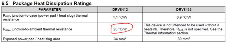

    5. Regard the Thermal resistance, I saw in datasheet that R-JA is 25 C/W for 8142.
    Considering power consumption of up to 12x4=48W per channel, what would be the heating temperature of each channel above Ambient with such R-JA ? Does it 48x25 ?
    [Comment] the OUT_x is also a pwm voltage with the same Duty Cycle as the input PWM but with amplitude of PVDD. Please make sure the output current is lower than over current protection threshold. We may insert an output inductor to keep the peak current lower than the over current threshold.
    [Comment] The thermal resistance should be gotten from 2s2p board. Please check https://www.ti.com/lit/an/spra953c/spra953c.pdf for the detail.

    You didn't answer, how does the driver exactly work ? TEC changes temperature as a result of current changing. How does the current being controlled in here ? You said the OUT_x/GND_x voltage is PWM with the same D.C of the input PWM but with PVDD amplitude. How does control the current change which cause the TEC temperature change ?
     Regard question 5 I will check t 2s2p board but I still wonder what does R-JA is 25 C/W mean here ?

    Question 5:
    For example: die temperature is 100C, ambient temperature is 25C, the device power loss is 3W, the R-JA is 25C/W= (100-25)C/3W.

    Question 4:
    I know that the duty cycle control is not related to DRV8412. I didn't ask how does the whole system exactly work, I already have a feedback circuit, that's not what I meant. What I meant in my question is, how does the DRV8142/ 8342 drives the TEC ? - Is it a current drive to the TEC PN junction or is it a voltage drive in which the TEC impedance varies ?
    Question 5:
    Yes, what you show in your example is also what I thought but how can I be sure from the data-sheet that maximal power loss is not much bigger than 3W ?
    It is claimed in the beginning of the datasheet that the efficiency is 97% but there is no chart showing in what current consumption that will be the efficiency ?
    how can I be sure that in my case of 12v/4A =48W per one channel the efficiency will be about that number (97%) so the power loss won't be bigger than 1.5-3W ?

    Question 4:
    how does the DRV8142/ 8342 drives the TEC? When the PWM signal is applied to DRV8412, DRV8412 will pass the input voltage to the output according to the PWM input signal. DRV8412 doesn't control the output current and voltage. The output current and voltage are controlled by the feedback system which adjusts the PWM duty cycle for DRV8412.
    Question 5:
    Please order an EVM to evaluate the thermal performance. If the device is too hot, you may need to check external FET solution, such as: DRV8711.

    Question 4:
    Answer: You miss again my point, I'm not talking here about the Feedback circuit, I'm asking how does the "analog front end"  drives the PN junction, but never mind I will figure it out myself. Thanks.
