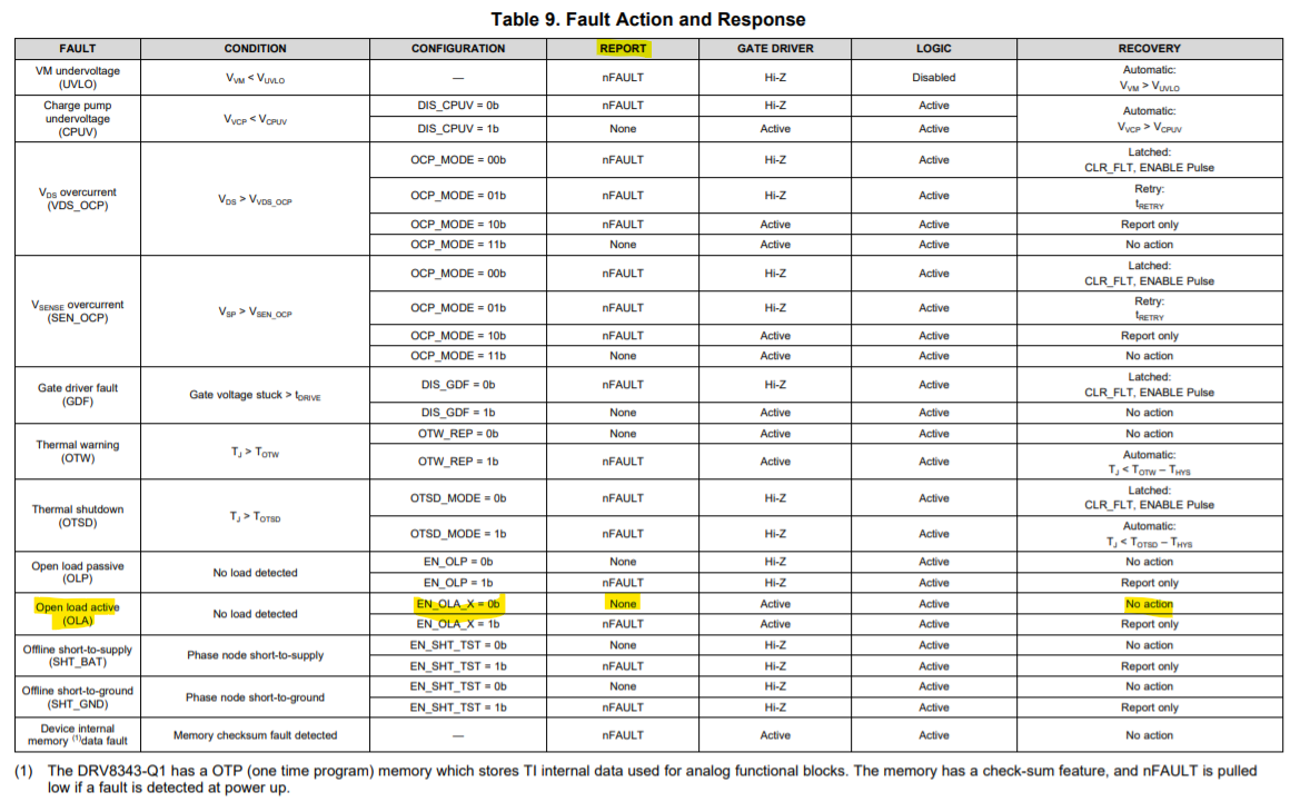

Is the nFault pin asserted when open load condition even though "EN_OLA_x" bits are disabled?
Kuramochi
