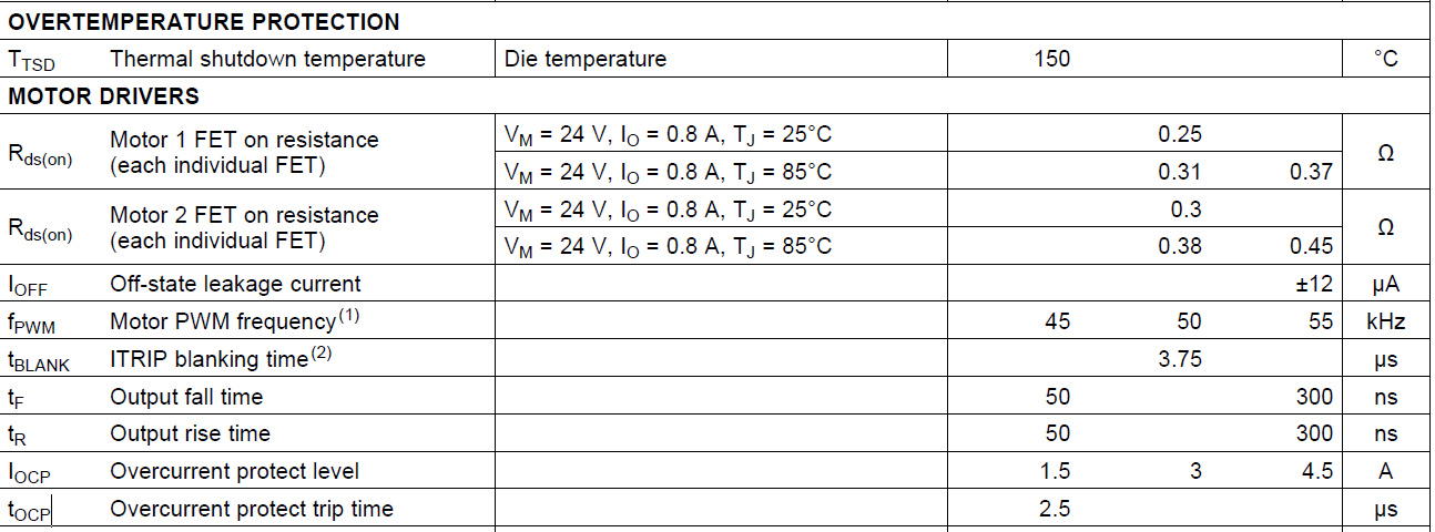

I am now using DRV8823 to control the two-step motor,Now I have the following problem.
1.How to make one motor run and the other motor shut down by register command control?
2.The attachment is the source code that I control the motor operation through registers. Is there any problem?
3.What are the overheat protection and overcurrent protection values of DRV8823?Schematic and source screenshots.docx

  • Hello, Dominic:
    1. The xENBL bits in the serial interface registers enable current flow in each H-bridge when set to 1. Bit xENBL=0 can shut down the motor.
    2. We don't review the source code. But, the EVM firmware is provided as reference which can be downloaded from  https://www.ti.com/lit/zip/slvc423
    3.  All motor driver device datasheets provide the OCP and OTS parameters in the spec table.
