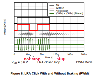

I found similar waveform in the datasheet as below,
Left is not stopped output signal.
Right can stop output signal by EN low.
Could you please let me know the reason of  not stop output signal? Is it due to the braking signal? (from above E2E session)

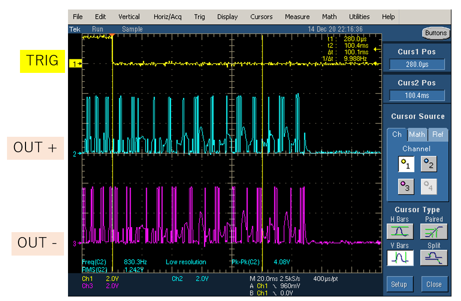

    Does your customer notice a 180 degree phase shift on the outputs when IN/TRIG goes low indicating breaking? If so then this is why the waveform continues after IN/TRIG goes low. this could be verified by setting register 0x1a = 0xF9 which will disable breaking. and then observe if the waveform continues after IN/TRIG goes low.
    In this case the back emf related to the velocity of the LRA will be the parameter controlling how long the output is driven after IN/TRIG goes low.
    The STANDBY bit can be used to immediately stop the device from driving the outputs at all, however if what the customer sees is braking, then I would not recommend this as the braking is generally desired.

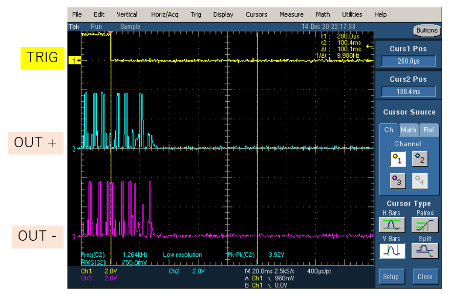

    Customer need braking function from their system requirements. So, they need to understand about the braking function, braking time (period) and root cause of this issue. Then, They have to adjust the delay between  IN/TRIG=L and EN=L(or STANDBY off).
    This issue is occurred over different periods of time between IN/TRIG=L and EN=L.
    Customer's software is programed the 1s delay between IN/TRIG=L and EN=L.
    Each waveforms are below,
    case1 : keep 130ms output after IN/TRIG=L.
    case2 : keep 30ms output after IN/TRIG=L.
    case3 : keep 1s output after IN/TRIG=L.
    * Above waveforms are an example, they have many cases.
    Q2. If the root cause is braking operation, is it possible that braking time is over different periods by tests, like above waveforms?
    Please refer the zoom-in waveforms after IN/TRIG turned Low, below,
    Q3. Is it braking waveform?
    Q4Could you please let me know the reason of this waveform?
           Also, if it is braking waveform, Could you please let me know the braking function mechanism?
    Q5. What parameters are the braking "time(period)" depend on? Is it depend on the actuator parameters?
    Q6. If they change the braking gain in the register 0x1a(FB_BRAKE_FACTOR[2:0]), how does it affect the waveform?
