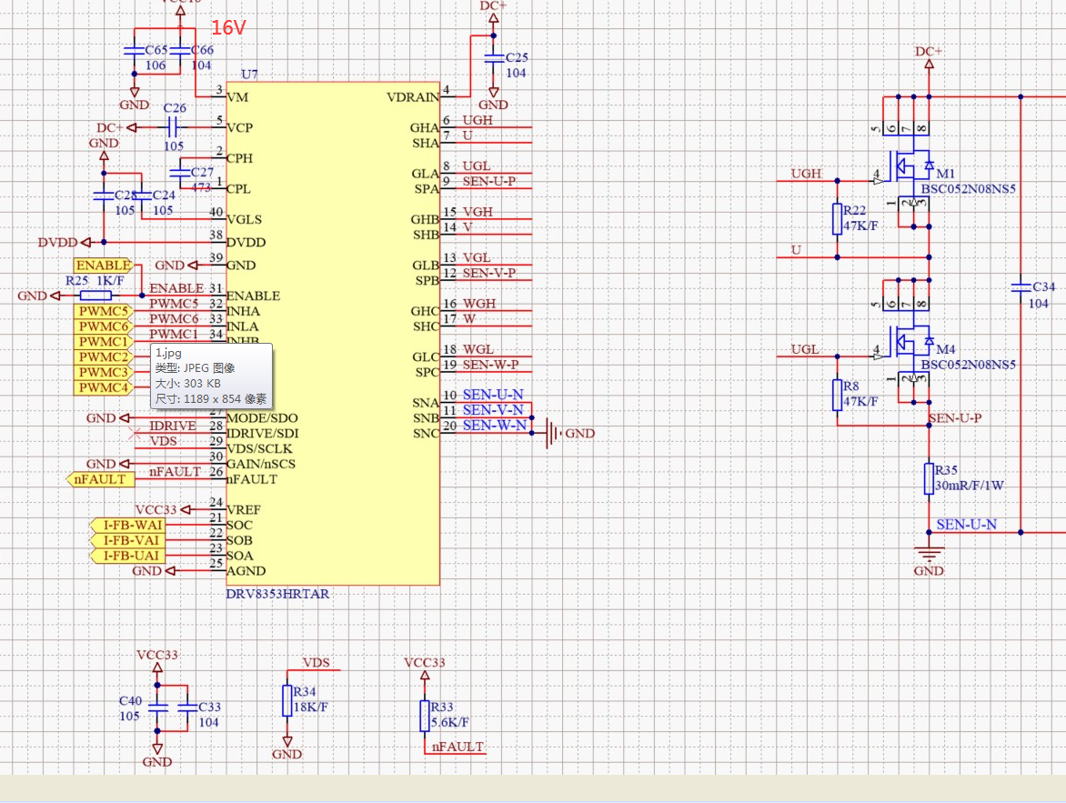

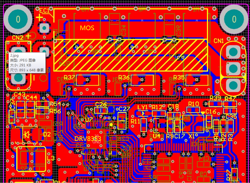

The Schematic and PCB  is as follows:
  • When the motor wire short circuit test,the device  is  damaged.There are two types of damage:
  • 1.High voltage side drive voltage C26 and Low voltage side drive voltage C24  are  basically 0 volts.VDVDD is 5V.And the DRV8353H 's  temperature reaches 150℃,the device  is  damaged.
  • 2.High voltage side drive voltage C26 and Low voltage side drive voltage C24  are  basically 10 volts,VDVDD is 5V.but the device No response to input PWM.
  • so,What may have been the cause of the damage? I had   damaged many  device.
  • Thank you !

    Assuming that, motor wire short circuit test means, phase wire of motor that is attached to the phase node, which is SHx, is attached to GND during operation, we know that a high side FET (which means a GHx is high), and the current surpasses the motor and goes straight to GND. Because the RDSON of the FET is much, much smaller than the resistance of the motor, the current will surge, causing voltage spikes that couple through the FET C_GD or C_GS capacitors and violate the abs. max of the GHx. In addition, the SHx nodes are connected to the low side FET drain, the spikes should also couple through C_GD and go into the GLx pins, which will also blow up the part. This makes sense why the VCP and VGLS, which are the gate voltage sources, would be damaged in the process as energy flows into the GHx and GLx pins.
    I'm going to assume, no faults were triggered on nFAULT. The interesting news is that the DRV835x might have a chance of detecting this condition. Specifically, SEN_OCP will not work in catching the fault as the sense resistor is bypassed. But the high side VDS_OCP has the possibility to be triggered.
    Right now, the VDS_OCP threshold is set to 0.1V which is around 22A for the 4.4 mohm RDS that you have for the FET. My guess is that the supply current rises so fast that by the time the DRVx tries to react, the device is already damaged as the current would have risen past the 22A threshold by the time the fault would have been triggered. Could try to decrease the threshold and see if its will catch the fault, but your threshold is already pretty low so I'm not super confident in that.
    The possible solution is to try to make the short circuit current "ramp more slowly". One example is increasing the FET rise and fall time. IDRIVE set to 300mA, right now and needs to be tied to GND for 50mA/100mA (Q_GD = 7nC where IDRIVE = Q_GD/t_riseFall) . You can also put some placeholders for RG and make them 0ohm to start, and increase to a few ohms. Both will make the gates rise slower. Another is to add in RC snubber circuits or C_GD or C_DS capacitors that will increase the time for current to charge them up.
    But in general, this is expected behavior given that it looks like you are not protecting against this condition in the schematic.

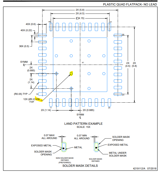

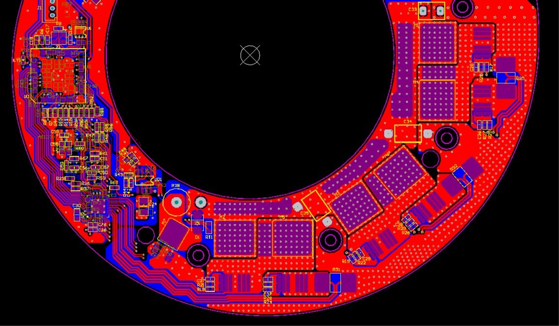

    I will say, it looks like the layout could be done better. I just noticed you're not following the mechanical diagram given in the datasheet for the thermal vias, there are supposed to be 10 of them.
    I also see thermal reliefs connections (instead of direction connections) on some of the components which is bad for impedance and current carrying capability signals. I've only seen 2 layers and I'm beginning to think these are all 2 layer designs which is extremely difficult to do on gate driver designs for this voltage. I also assumed that GND, in your schematics, were connected to the same net, despite the different symbols being used. But they look more like isolated planes, which is not recommended.
    As such, I highly recommend you take a look at our recommended layout app note if you have not already. Voltage spikes and separated GND planes only make these problems worse. For example, the GND at the part is 0V, then the GND at the power MOSFET stage sees a voltage spike, and there's inductance between the two nodes (because they are routed as separate planes with small connections between them). This means, additional voltage is generated before the dI/dt can recover and make the nodes the same voltage (V = L*di/dt, after all). You can do a simple SPICE simulation to verify this.
