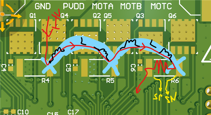

  • Turns out AVDD is (I think) shorted internally to SN1 (source of Q4). Thats why AVDD was 0, since SN1 is right before the shunt. One of the OP amps seems broken. It's not getting its 1.6V bias either. Not sure why it happened. I cut the trace from SN1 to the DRV which makes everything work again.
  • Same thing happened now with the other OP amp. The only one remaining is the one which still has a shunt connected to it. Some kind of overvoltage somehow? I get a feeling I'm missing something stupid now. This is the schematic now:
  • Hey Niclas,
    I agree on your assessment of damage. These are usually caused by negative spikes on SNx or GND (SPx).
    Also, I agree with your schematic, I've given the layout view for your reference. Note if your wires are skinny or long (look at the comparison of cross sectional area and length for the depopulated current sense resistors), then inductance will be added in the path and your much more likely to see spiking on as previously mentioned.
    Remember, you're dumping amps of current through the phase and if you introduce inductance in the path because of LC resonance, you'll be seeing spikes. You could probe the voltage at the node to get an idea of how bad it really is.
    Edit: also tie your unused CSA amplifier inputs together if they are not being used so they don't trigger any faults.
    Do you plan on using single current shunt in the future or are just just trying to get it to work? A personalized layout for single shunt will fix these types of issues.
    -Cole
  • You are probably right about the introduced inducance. My wires are a bit skinny! I will tie the CSA inputs together, thanks! Right now I'm just trying to make it work, and I will make a personalized layout in the future. Thanks!
