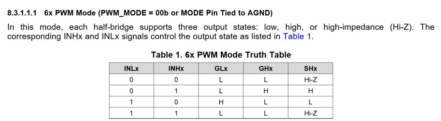

  • Hello Gopi,
    You are in a fault condition (nFAULT = 0). Are you able to read the SPI registers (0h and 1h) to diagnose which fault is occurring?

  • Hello Gopi,
    Have you tried this same test on multiple boards & parts or just on one board & part?
    I assume you re not doing any SPI configuration at this point. Is that correct?
    DRV8353R will initialize with the default register settings, and some of these settings may not be ideal
    • IDRIVEP_HS maximum (1A), could cause damage to system due to too fast switching
    • IDRIVEN_HS maximum (2A), could cause damage to system due to too fast switching
    • IDRIVEP_LS maximum (1A), could cause damage to system due to too fast switching
    • IDRIVEN_LS maximum (2A), could cause damage to system due to too fast switching
    • VDS_LVL (1V), could be too high to protect the MOSFETs
    Are you applying the same pulse to INH and INL simultaneously? Or are you applying the pulses one at a time?
    Matt

  • Hi Gopi,
    When you apply the same pulse to the high-side (INHx) and low-side inputs (INLx), the output will remain OFF based on the 6x PWM table:
